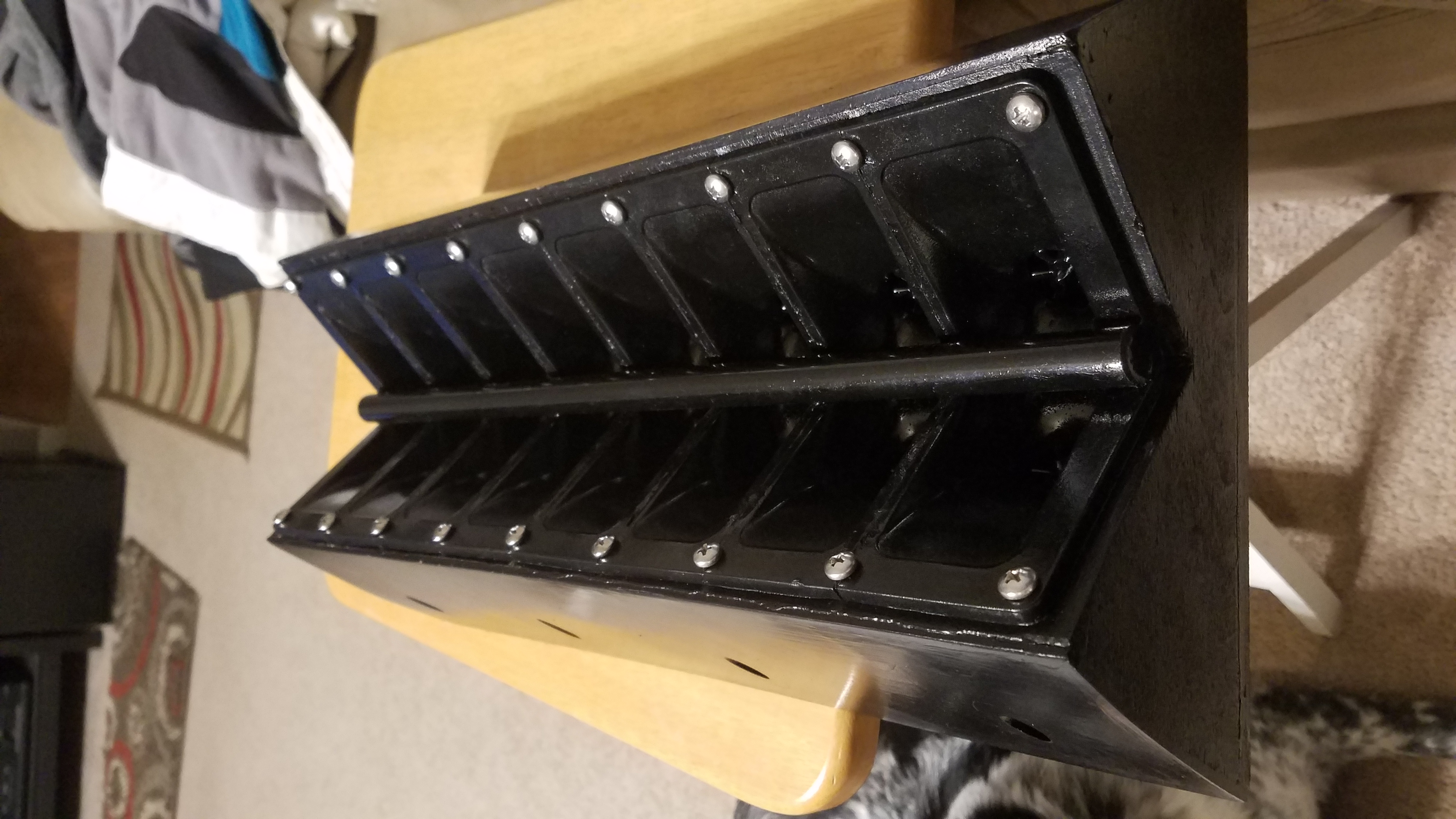

Re: HowieZ DR200 build
One array module mounted and ready to seal a woofer chamber.
Bill, I'm putting egg crate foam in the sheath sides, and then top/bottom. What I ordered turned out to be a bit dense, and it's closed cell. It's like a black foamy rubber 1inch thick or so, then some eggcrate bonded on top. Is that going to be too dense, or take too much chamber volume? I got the sense we were 'stuffing' more than soundproofing, and I feel my choice (ordered online) has done the opposite.
