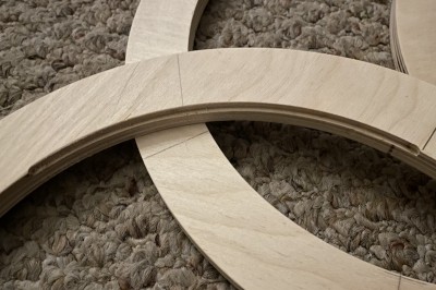

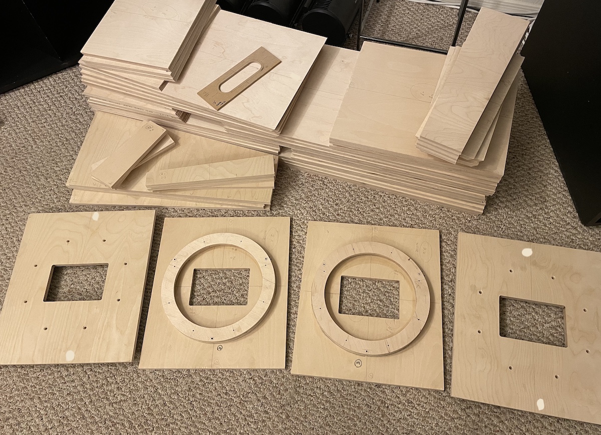

Got all the panels sized and bevels cut. Been slowly threading this construction through all that's going on lately as I don't get much time to crack into shop projects much these days.
The lion's share of braces all trimmed to the layout lines. This weekend was spent diving into the baffles...starting with the spacers. Only hiccup was on the third spacer (see the close-up), I started to cut with the Jasper jig in the wrong hole. :bash: Luckily it wasn't too far off the mark, was a first pass cut, and I caught it early enough. Sandwiched between panel #2, this will be an easy recovery with a touch of Bondo and light sanding. Driver cut-outs in the baffles up next, glue the spacers down, and onwards to the drill press for the fastener holes.

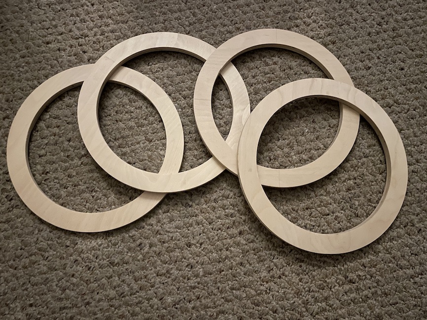

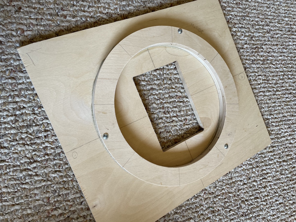

Slow going, but the baffles are where attention to the details really count, in my experience. Here I've located, centered, and glued the spacers down in one step using using a trio of long shank pocket hole screws, cut so as not to protrude all the way through the baffle.

Spacers cured in place, I remove the screws. The holes located such that they won't interfere with the driver gasket surface and driver bolt circle.

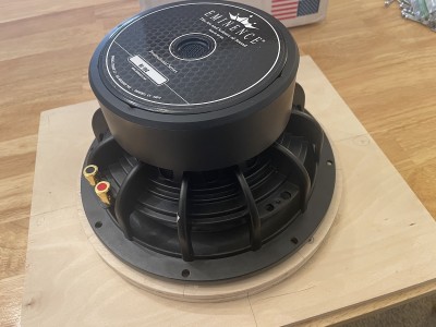

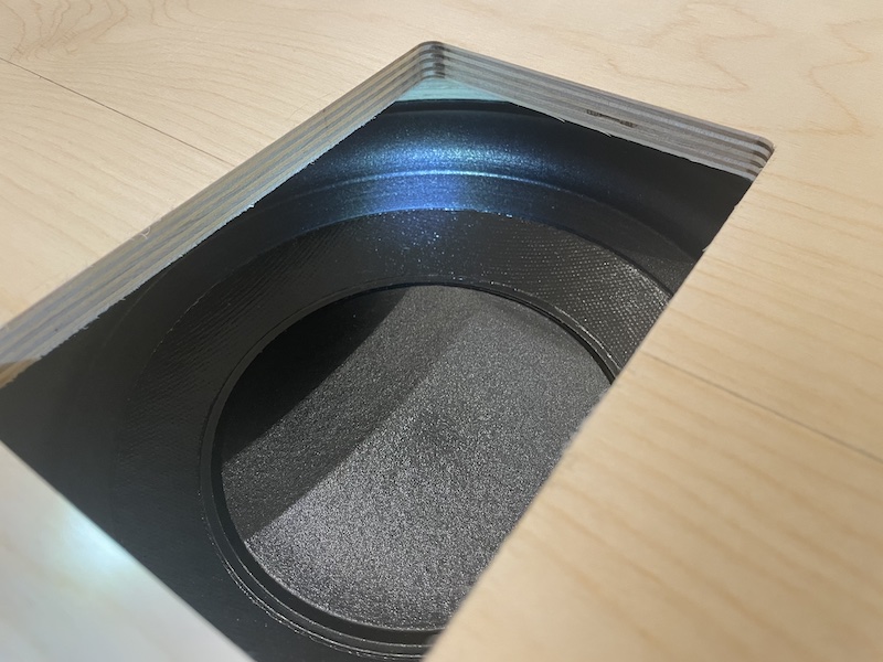

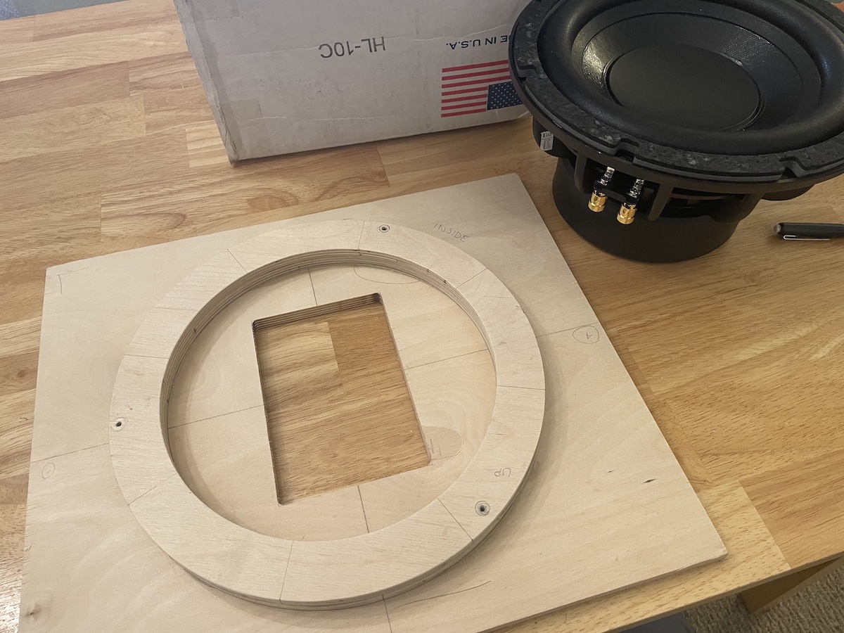

View of the driver in place, from the throat side of the baffle. Looks right at home. :twisted:

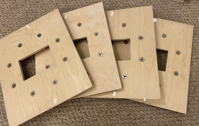

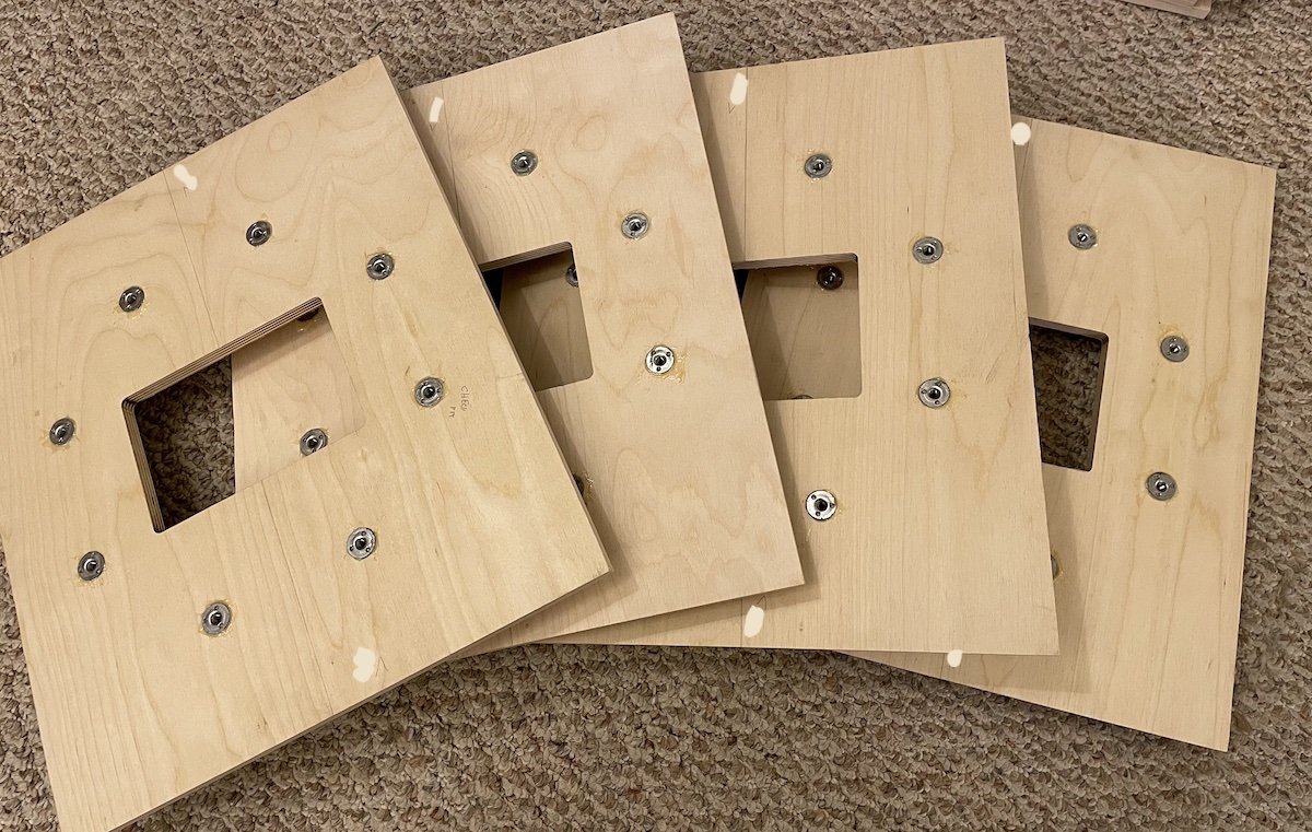

Inner panels and baffles for four slim cabs. 3 hours at the drill press got the bolt-circles correctly located, piloted, and prepped (counter bored and countersunk) to accept H-nuts. All the while remaining perfectly square, so that the nearly 8 cm long bolts actually thread into their respective nuts on the other side of all that spacer material. Lighter spots of color are some IP dimensions I fuzzed over.

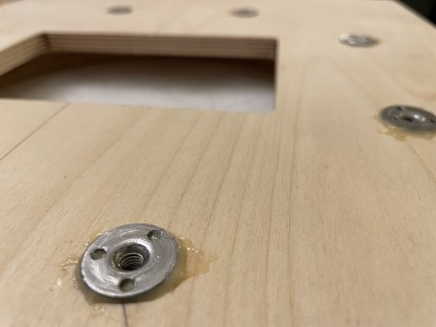

Ahhh...Money shot of the dreaded H-nut. Repeatable 2000 lbf clamping load for any Eminence 8-bolt 10 inch driver for years to come. Another 3 hours in the shop mixing epoxy and squeezing everything into place with the arbor press. The trick being, to keep the epoxy out of the threads at all cost.
Posts: 2068
Re: Radian's T48 slim build
#41 Post by Radian »
Messy and a complete PITA to get right, but soooo worth it my book. Baffles done, onwards to dry-fitting cab #1...

Beautiful!
I chase my threads with a tap to clean them up after epoxy, coz i'm MESSY!
