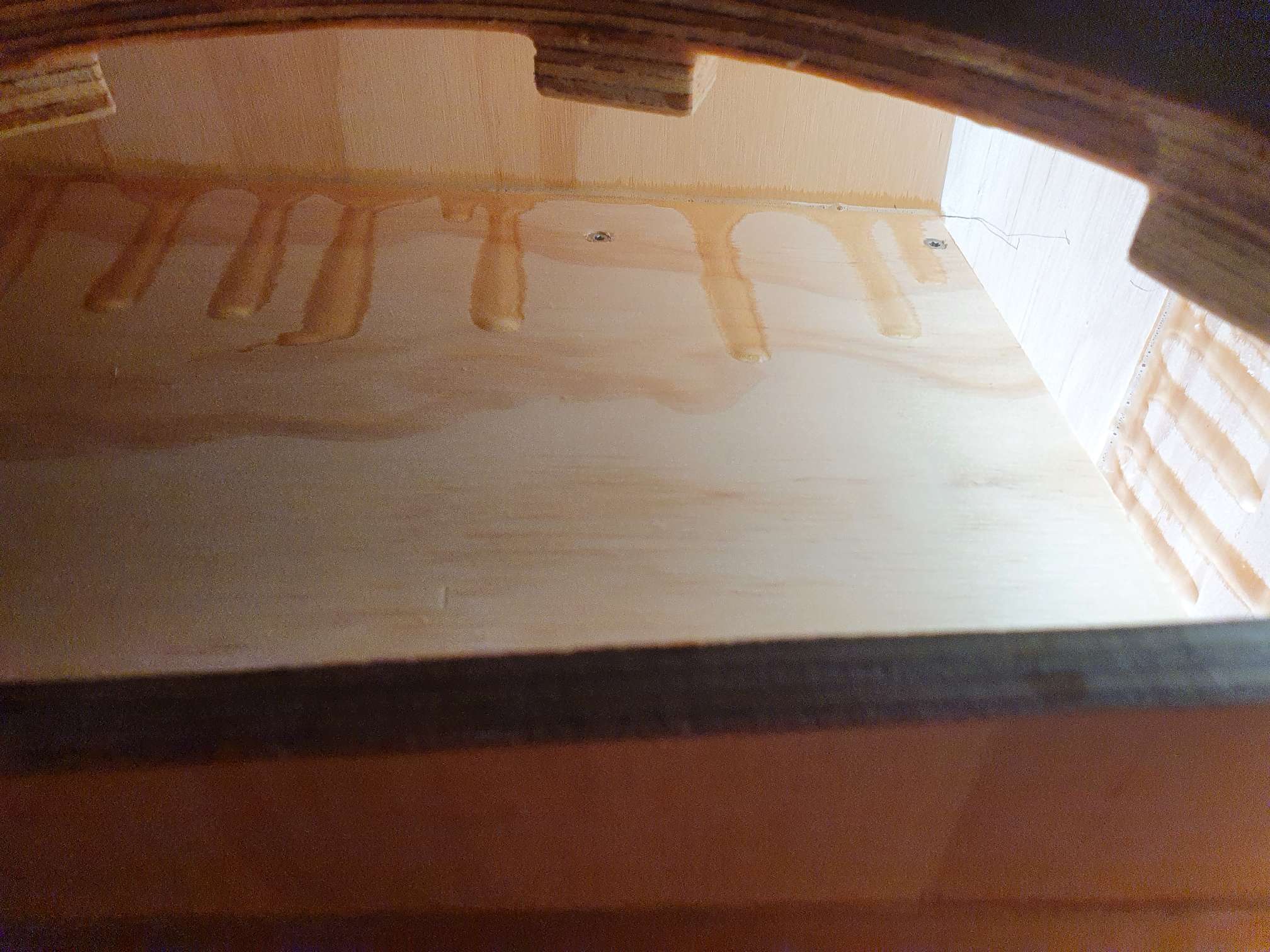

I don't think I'll be able to sleep for at least 2 hours.
The stress!
As you know this side was warped too.
I placed it on the sub, and I was able to stand on it, without being able to "close the gap". I could just make it connect while jumping up and down on it. I had too use some pretty big screws to pull it tight - while standing on it.
But at least I won't be like "I think it's tight".
I know its tight. Photo documented. Plus I'm able to turn it, and chaulk all the joints with more glue, tomorrow.
Enjoy the inside view of the THT!
The stress!
