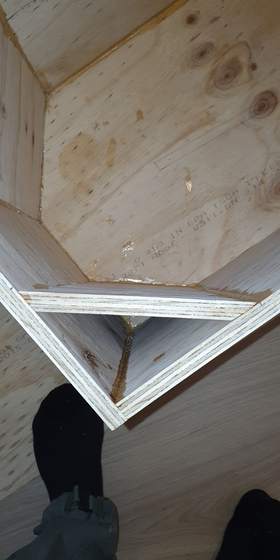

I have attached a picture of it, where you can see the new (Very foaming) glue line applied outside of the joint to seal it. You can also se a glueline of the old, less expanding glue.
Should I but something else?
