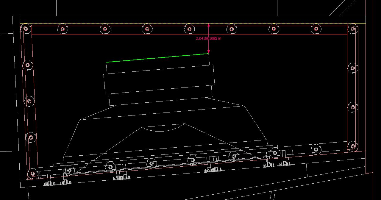

howiez
Posts: 382
Re: THT Driver
#4 Post by howiez »
I have the Dayton RSS390HF in mine. I modeled a crude 3D shape for the driver to check clearance in my THT access panel. When mounted, I'm showing 2" of space from the back of the magnet at the 7" depth of the RSS390HF. I would concur then that your 8.25" deep should fit in the chamber. Getting through the access panel is a different story. If you use the normal side panel, I think I have between 5/8" and 3/4" of clearance worst case. Without verifying the magnet diameter at that 8.25" depth, I can't say for sure...
I don't remember what driver is in the sketchup, but i'd try to copy/move that into the opening and chamber to see how it fits to give you a better idea.

Posts: 29087
Re: THT Driver
#6 Post by Bill Fitzmaurice »
The problem is that it won't fit into the access unless you mount it first and then attach the flanges. With the LP version there's plenty of room.
