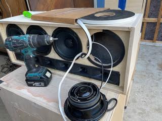

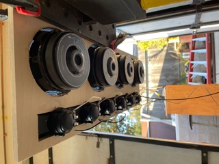

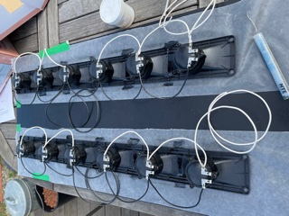

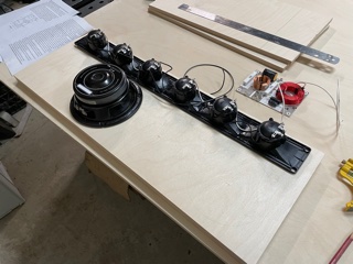

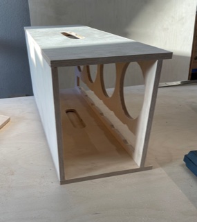

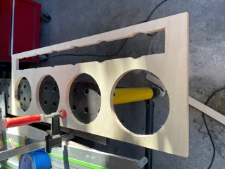

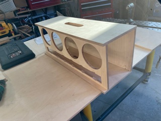

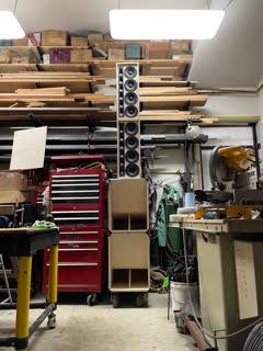

Just some SLA Pro 4x6 pics. This build was very easy compared to that Tuba 24. Some wise forum members talked me out of a DR250 build for an upcoming event, there just isn't the time. I'm still building the DR250s next year.
Crap, Im' gonna sneak one question in here. I'm wondering would the SLA PRO 4x6, stack/play well with a pair of DR250 and 2(4) Tuba24s?
I'm imagining: Tuba 24x2(2 more coming), DR 250x2, SLAPRO(4x6)x2, and QSC GX7 amps x2.
The SLA PRO 4x6 plans talk about adding a pair of SLA PRO 2x4s for stacking. 2x4 on bottom toed in, with a 4x6 on top. The plan does not mention pairing 2 sets of SLA PRO 4x6? i'm guessing the ohms might drop too much.
If they would work together well, the 2 pairs of SLAPRO 4x6 would vertical mounted? Would there be any benefit to side by side mounting, with maybe just a smidge of angle away from each other, 10 degrees either way? Dare I ask if they could be stacked horizontally on their sides (array) like two eight eyed monster spider faces? It seems like those tweeters could do more damage up front, before thirty feet out.
Things keep changing right in the middle of the build and I have to consider the whole system and where to go next. Do I just forget about the DR250 and just, once again, stick to Bill's plan? Make the 2x4 SLA PROs and two more tubas to expand the SLA PRO 4x6 system? Make a separate system that is DR250-centric?
So... Tuba 24 x2, SLA PRO 4x6 x2, SLA pro 2x4 x2, two amps getting 700-1000watts out. This seems to be the set up for a SLA PRO based mid system. Yes?
To try and squeeze in DR250 in there somewhere?
enuf....here's some pics. This was a satisfying easy build. Thanks Seth and Bruce for suggesting it.

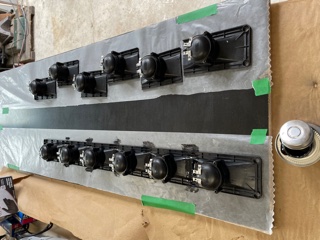

Leland has been busy soldering PCBs, I've got some XOs/filters on the way. I have a mountain of drivers right now, all I need. The wiring is about all that is left. Still in line, like everyone else for Eminence, the original drivers order. Those will be for the other Tuba 24s to be built.

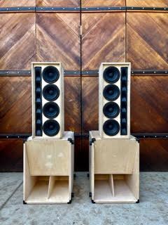

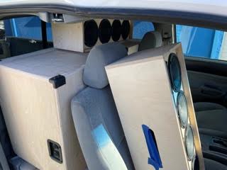

Well fired 'em up, very nice. That's two Tuba 24s-18 inches wide, inside the cab of a Tacoma in the jump seat, and two SLA Pros thrown on top. I had to store them out of the way so made an 8 foot 10 array. It's going to be a shame to paint these.

Craig, that's awesome man! Great job gitn'r done
So... you have the artist's eye, eh? I've always found paint (Duratex) to be one of the most satisfying parts of the build. But, over the years, many other people have chosen much more artistic approaches to finishing the cabs. No one says they have to look like everything else out there. I prefer mine to look the standard part, but your ideal may be unique. I look forward to seeing your cabs finished, however that ends up being.
What was your impression when you fired them up? Did you set up any of the limiting and EQ at all?
Re: Build Progress
Thanks! And thanks for all the help, I really appreciate it!
We set it up a few different ways, and the driverack was its own challenge. Had to figure out that mutes do what they are told, moved the subs a few times for the RTA mic, just navigating another screen....hateful(sure, it worked well tho, once we caught up to it). Then we transferred all the EQ info over to the analog 31 band and the old rack analog XO, and ran that for a while. It's way easier to just run that wizard, but It is kind of more satisfying to have that aural/tactile feedback of sliding a fader and hearing your changes. This was just running program material basically, Earthwindandfireseptember over and over. Next practice we will set up the big board and sound check. Need to buy more coffee to brew, lots of more work to do.
It sounded clean as hell. Sweeping the crossover between 80-120 was interesting. Man...it had us thinking it was under powered. We kept looking at our gain structure. Was this system under powered? Nope, it's just clear and it doesn't hurt. We went outside and checked, we could hear it everywhere. It wasn't what we expected. I think it's better. We will know for sure if the vocals can't get louder than the guitars. I think it's fine, I'm just over thinking it because so much went wrong prior to running it.
