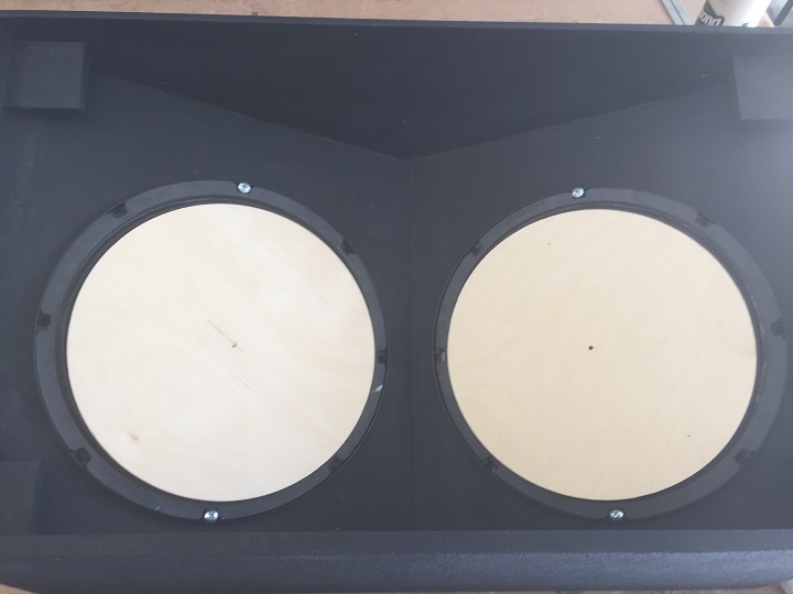

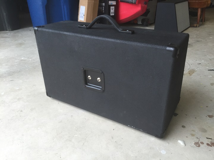

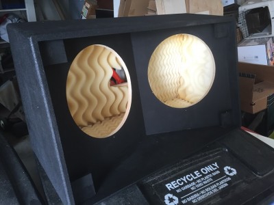

If you want it closed back, then just attach the back panel with glue and put the Tolex over it. That's how I built mine....I just used Duratex...

No, that's duratex - I do all my cabs that way.
I just put some cleats on the inside corners of the cab as a stop.
The grill frame and cloth is a compression fit. Made the frame about 1/8" smaller than the inside opening. The grill cloth makes up the difference and creates a snug fit.

I have used Durtex in the past but I stopped because customers ( not me) don't like it. So the I still pose the original question, will tolex on tolex create the air tight fit. Also, did you use a gasket around your jack plate?

Tolex on Tolex? Maybe......but I guess the question is - if you want a sealed back, then why are you making it removable? Just glue the back on as a single piece and cover over it....then it's airtight.sloaneamps wrote: ↑Sat Nov 13, 2021 10:52 pm I have used Durtex in the past but I stopped because customers ( not me) don't like it. So the I still pose the original question, will tolex on tolex create the air tight fit. Also, did you use a gasket around your jack plate?
Unlike a PA speaker, I doubt you'd hear a whole lot of difference between a totally closed back and a closed back with a tiny leak around the Tolex.
But, you can always use gasket tape between the back panel and the box. Just allow for it with the set back on your cleats.
Also, the convertible back option in the plans isn't air tight either.
Easiest is just using a single piece of ply for the back and save all the extra work unless the customer really demands that it be convertible.
