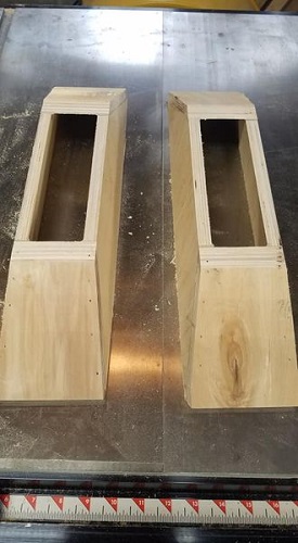

I've gotten my horn throats and spacers glued up overnight clamped flat to help with warp.
They lay nice and flat on my table saw, i'm happy .

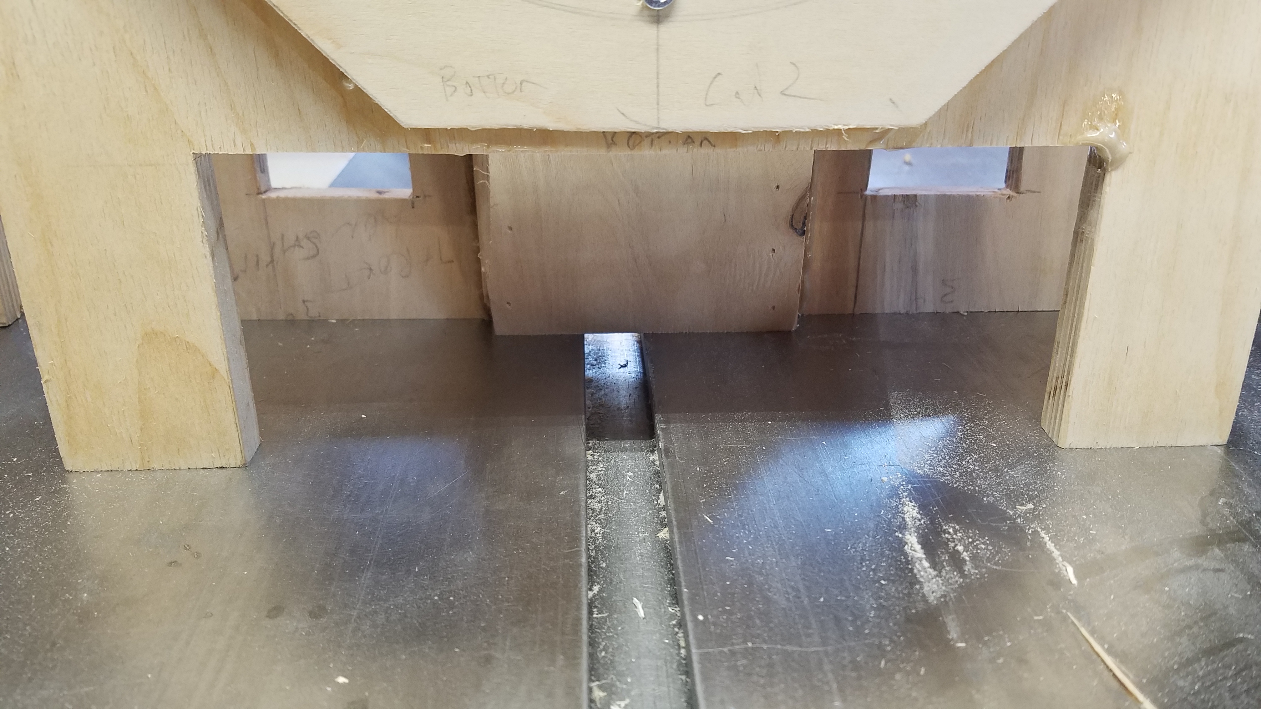

Next I mocked up the whole outer shell to get the woofer baffle and horn throat lined up/square.
Once I had them in a decent location, I pinned the baffle to the throat with three quick 18ga nails.
Then I laid them flat and clamped them a bit to shoot a few more pins in them.
I can lay either 3degree taper on my table saw and they all sit flat, very pleased with this, when most of my woodwork is like snow skis!

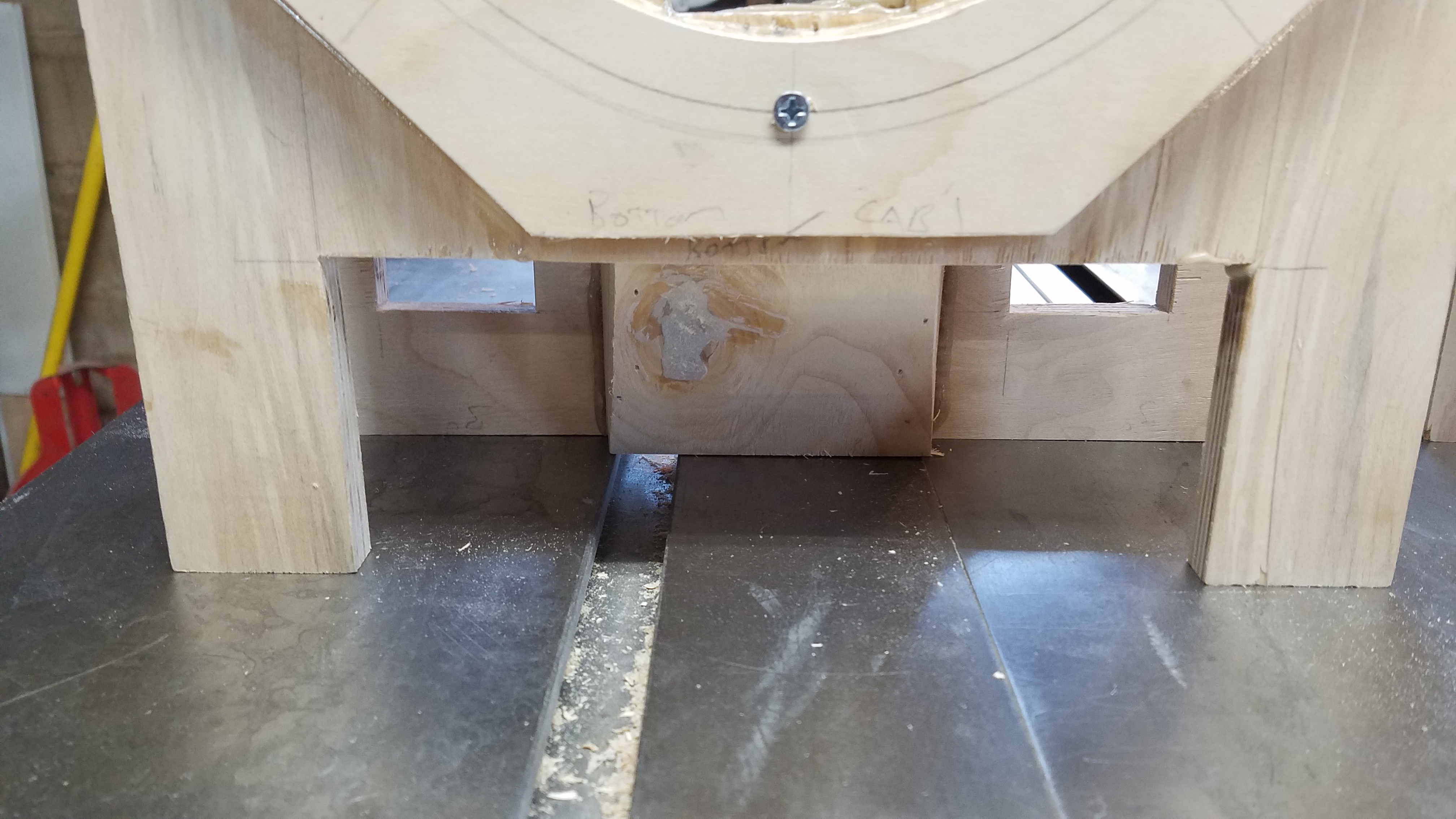

Last recent progress, i used a cleat per Bill's plans to get the baffle/spacer on the line, square to the bottom then top.
I glued and nailed one at a time, bottom first, 3 tacks to get close then stood it up removed the cleat and a few more nails.
Then I repeated with the top, cleat for square/alignment, a couple pins to hold, then stood her up and shot a few more.
Next I put this woofer baffle/horn throat/spacer assembly in the cabinet mockup again to ensure square as the PL cures.
I put one clamp in the buttcheek crack to hold the top/bottom to the sub assembly.
Then I laid the face down on my saw table, laid the sides against it, and used a band clamp to snug it up.
Then I checked square on all 4 corners, cab one is perfect, cab two is a bit of a parallelogram.
So I put a clamp on diagonal and persueded her into square.
