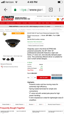

I came here 2 years ago looking for: best bang for the buck, DIY or die, underground audio solutions and philosophy. I found it. What does that mean exactly.
Well today if I were to try to build on my own a portable sound system what would I do on my own. I would shop for gear and research right. I find these buyouts at a smoking price. They seem to be a great solution let’s model them best I can.

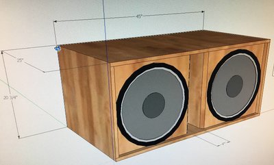

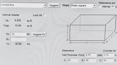

Next I would design an enclosure and if the combination suits my goals/needs then I’m done. I like the price and way that two of these subs models with my program.

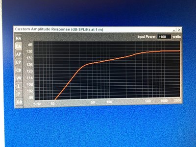

This cabinet is pretty close to a tuba45 in its dimensions!!! It’s output aka spl and frequency is pretty similar to a tuba45 cab as well at least it models that way. The dual b-52 18” cab requires 1100w where the tuba45 needs 300w.

It maps like it will play within max Xmax to 35hz at full power what do I know like I said if I was on my own this is best I can do on budget.

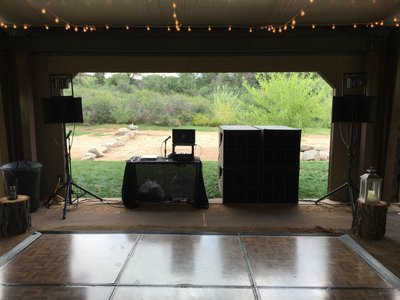

So I reckon I could build a single cabinet like pictured for about $250. If I want four $1000 and I would need 4400watts available. I can build a single tuba45 for $350-400. So for 4 tuba 45 cabs $1600. I bought my crown amp for $600 and it does 1200watts easily. I would need four of them to power the above proposed dual 18” loaded cabs so that would cost $1000for the subs plus $2400for the amp(s) totaling $3400 vs the BFM way costing a total of $2200, $1600 subs and $600 amp. That is $1200 less and requires 1/4 the power the BFM way, which is a big deal as a wall recepticle is only good for 1800watts arguably.
So even with crazy good buyout sale prices I still cant do as well as the BFM way on my own. What more is there to say. I just picked up an expensive little honda portable power inverter rated for 1800w and I can run my whole rig full tilt off it all night I could not say that if it were with my proposed b-52 subwoofer setup for more money!!!

You forgot to mention the sound quality too! There is no direct radiating sub out there that can touch the definition of a horn! Money aside, if you can't power the rig, you can't play. The ability to run a formidable rig off of 1 outlet is a godsend to a mobile operator as many times that is all you have to work with.
