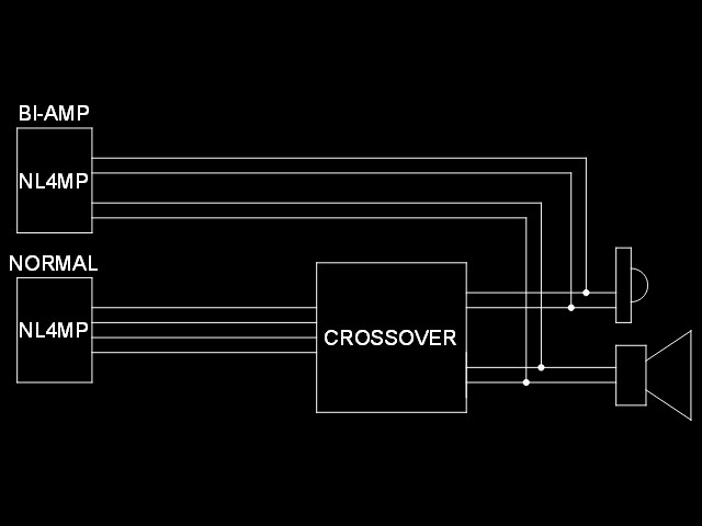

I Bi-Amped my DRs even though they had Piezo arrays, not for performance gains, but I liked to turn down the gain on them.
For simplicity sake (one less amp to haul around) I'm wiring my new Otop8s (CD not piezo this time) with a passive, BUT I want the ability to bi amp in the future, should I feel the itch to do so.
I'm sure this wouldn't normally be recommended, but will this work? I've seen other commercial cabs with a bi-amp and normal inputs...
Was also thinking about adding a Zobel filter to the mids? Probably not recommended if Bill didn't put it in the plans...
And was also thinking about a fixed L-Pad for the highs? I suppose the answer to that would be to just EQ down the highs if they are too much?

On the NL4 for the passive - you'd only have two wires coming into the crossover (full range).

I'm fairly certain you'll need to put a switch in that isolates the crossover from at least one of the drivers when in bi-amp mode. Otherwise, the two amps will be connected through the crossover circuits.
On second thought, you might be able to just put a switch on the input side of the crossovers that simply disconnects the inputs of the crossovers from each other. But, I have no idea whether the crossover circuits would alter the sound by just having their outputs connected to the speakers or not. If not, I think this would be the simplest solution.

For any crossover steeper than 6dB/octave, you'll need to disconnect the drivers from the crossover. Otherwise, the amps will "see" the drivers in parallel with extra components, which may cause substantial problems.

Rune Bivrin wrote: Mon Sep 13, 2021 4:28 am For any crossover steeper than 6dB/octave, you'll need to disconnect the drivers from the crossover. Otherwise, the amps will "see" the drivers in parallel with extra components, which may cause substantial problems.
Ahhh yes I didn’t think about components being parallel across the coil of the speakers.
