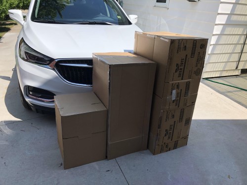

OT8, 18" wide T39 and 18" wide T48

Those cardboard mockups are an awesome visual :thumbsup: I look forward to seeing which direction you choose.
