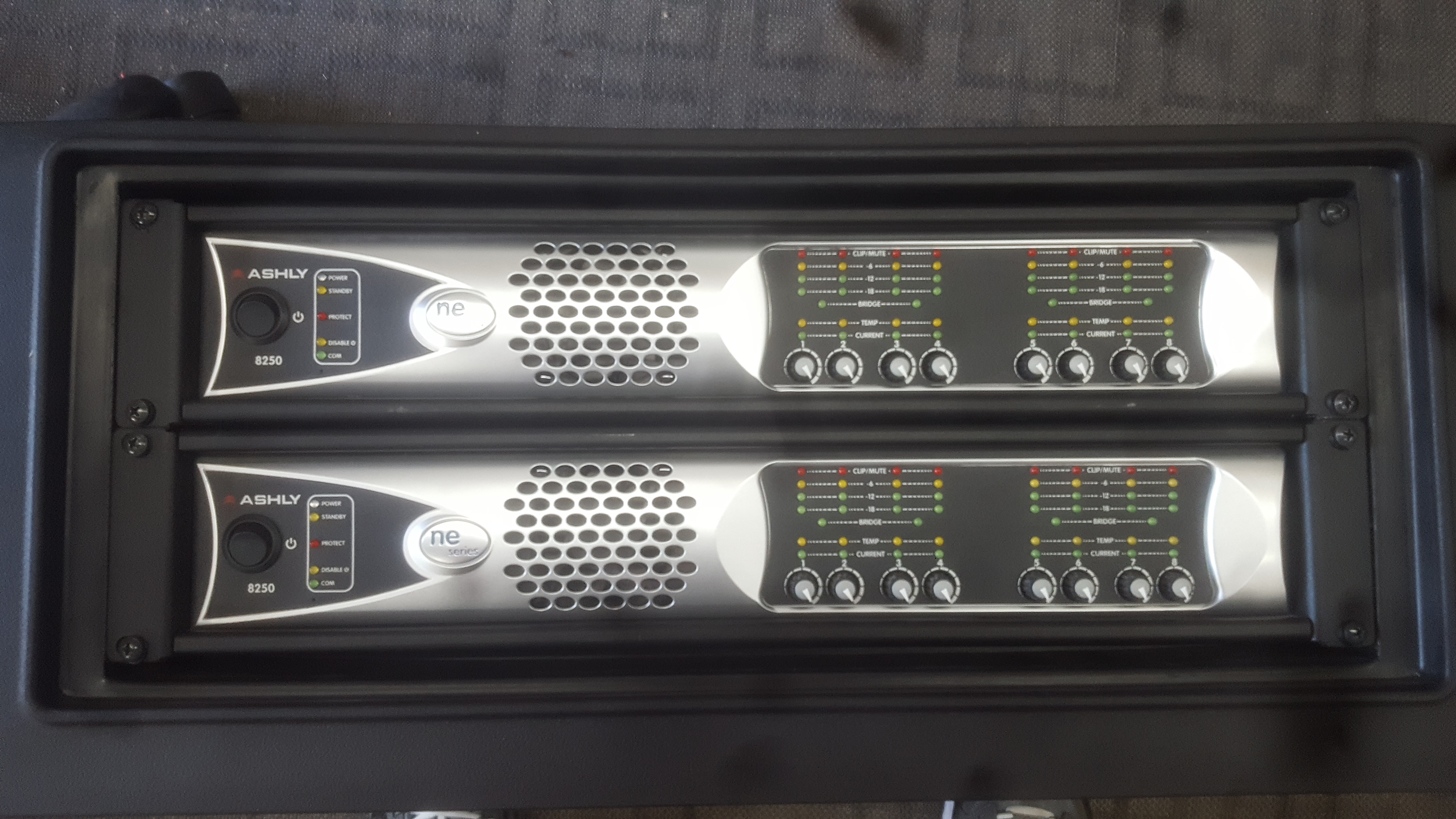

Yeah, I've got 4 of those 8 channel amps. I'm really looking forward to running a whole gig on 1 amp, or at least test out how viable it is. By the numbers and charts it should work quite well for small to medium outdoor gigs and any reasonably sized indoor gig. It's 150x8 at 8 Ohms, 250x8 at 4. With 4 channels for monitor mixes (4x WH6's), 4 DR200's on 2 channels, and 4 T39's on 2 channels. The WH6's won't need that much power, the DR's likely won't need it either, and 4 30" wide T39's could certainly take and use more, but on 500 combined watts they should be able to handily outperform what typical 4x18's would do on 2000 combined. So, should be ample. Tiny 6" monitors, tiny 8" mains, tiny 12" subs, and one amp. The thought tickles me.
I've posted this before, but yeah... here's 16 channels of amplification and each channel has tons of DSP options available... crossovers, EQ, Limiters, etc.
