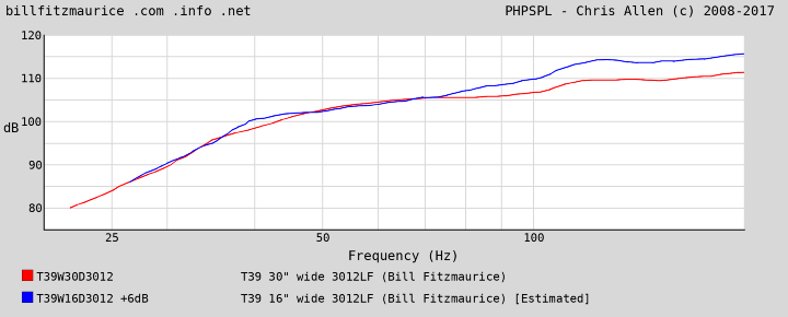

Food for thought...
Could you fit two 28-30" cabs instead of four slims? Half the number of drivers, half the load on the amplifier, half the number of cabs to wheel in and out of a gig... Essentially the same output potential.
Let the horn do the heavy lifting instead of amps and drivers...
Two 16" vs. One 30" T39

Very wide cabs give the most bang for the buck and are the way to go if their size doesn't present a problem transporting them. You can get equal or better results with narrow cabs, but you need more of them, which means more drivers to pay for.
