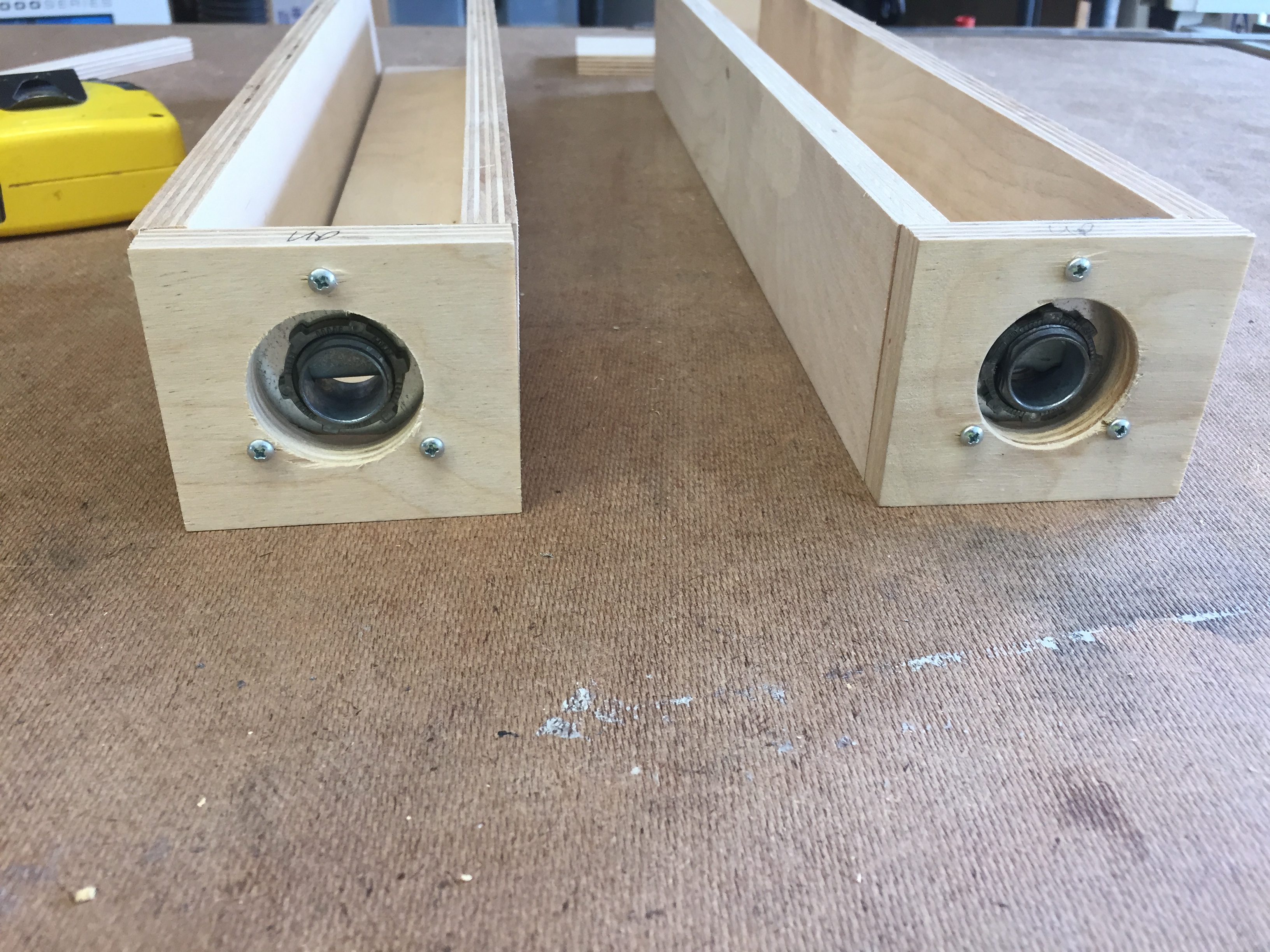

One of the head scratcher on the build was how to attach some kind of strain relief for the cable on the wooden box. First thought was the relief used on electrical boxes......the problem is that they aren't long enough to go through 1/2" ply. I could always rout out the ply to make it thinner, but then you couldn't access the tightening screws.
Next thought was to just use a metal plate for the end cap on that end. I found some plates for a 4 gang electrical box with a knockout in the middle. That could be cut to size and attached to the end......one problem.....then I'd have no place to screw the rack panel.
So, I married up both ideas. Kept the wooden end plate so I'd have a place to screw in the rack panel, but drilled a hole in it and cut down the metal plate to fit on the backside held by screws. That way everything has what it needs to connect and the strain relief is accessible from the inside.

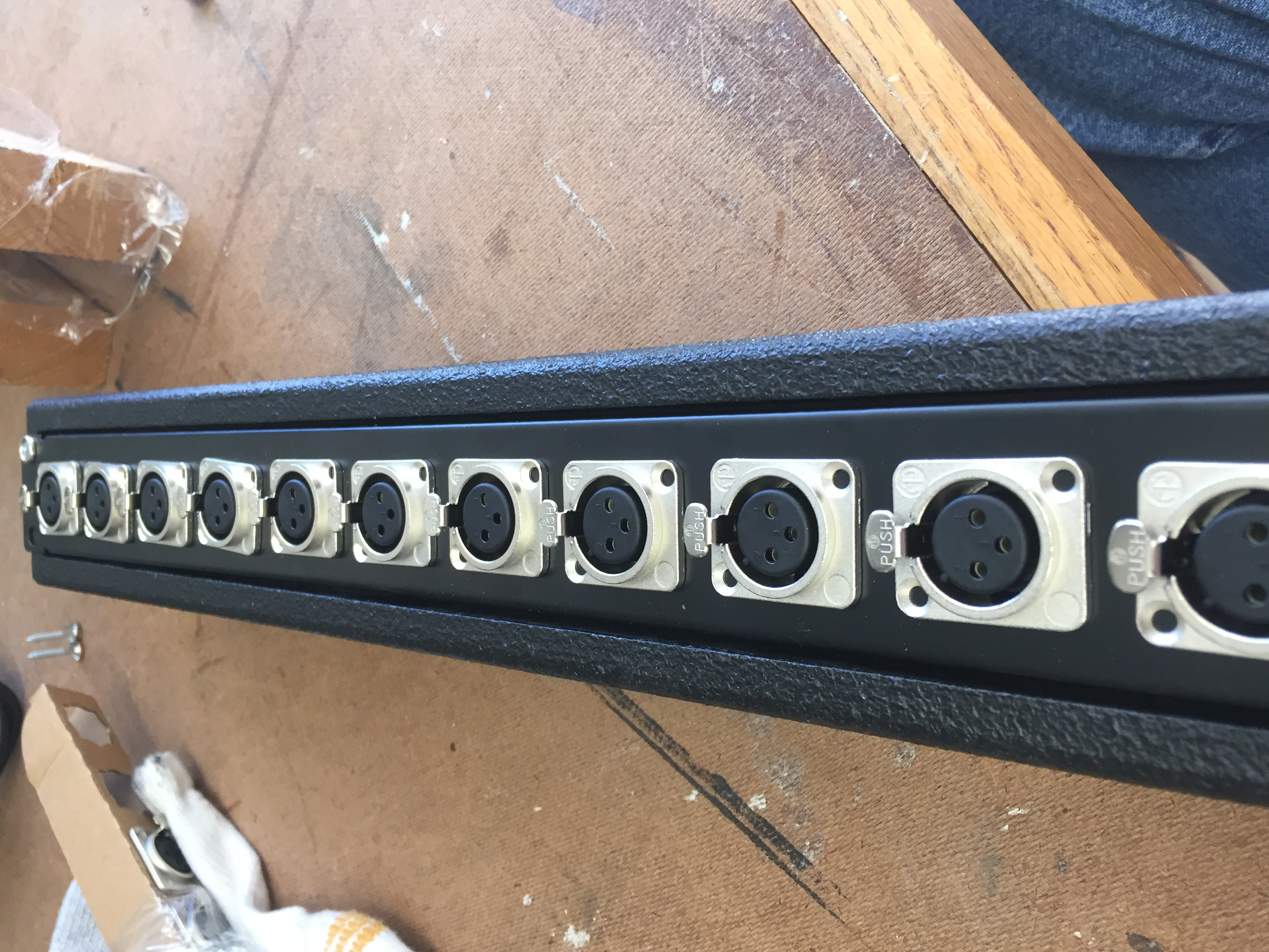

First, it's drilling 22 3/8" holes for the Greely Knock-out punch. If you are building rack panels - this tool is a must. Spent years drilling holes with a step drill bit....nasty, messy, and metal shavings everywhere.
The punch makes perfect holes and leaves little discs to throw away....
Next, had to decide whether to orient the connectors in-line or side-by-side. Inline looks better, but side-by-side will be easier to unplug cables and to label....
After lots of little 1/8" holes (44 of 'em), the connectors are secured and the panels are finished.
This is the end plate with strain relief installed...

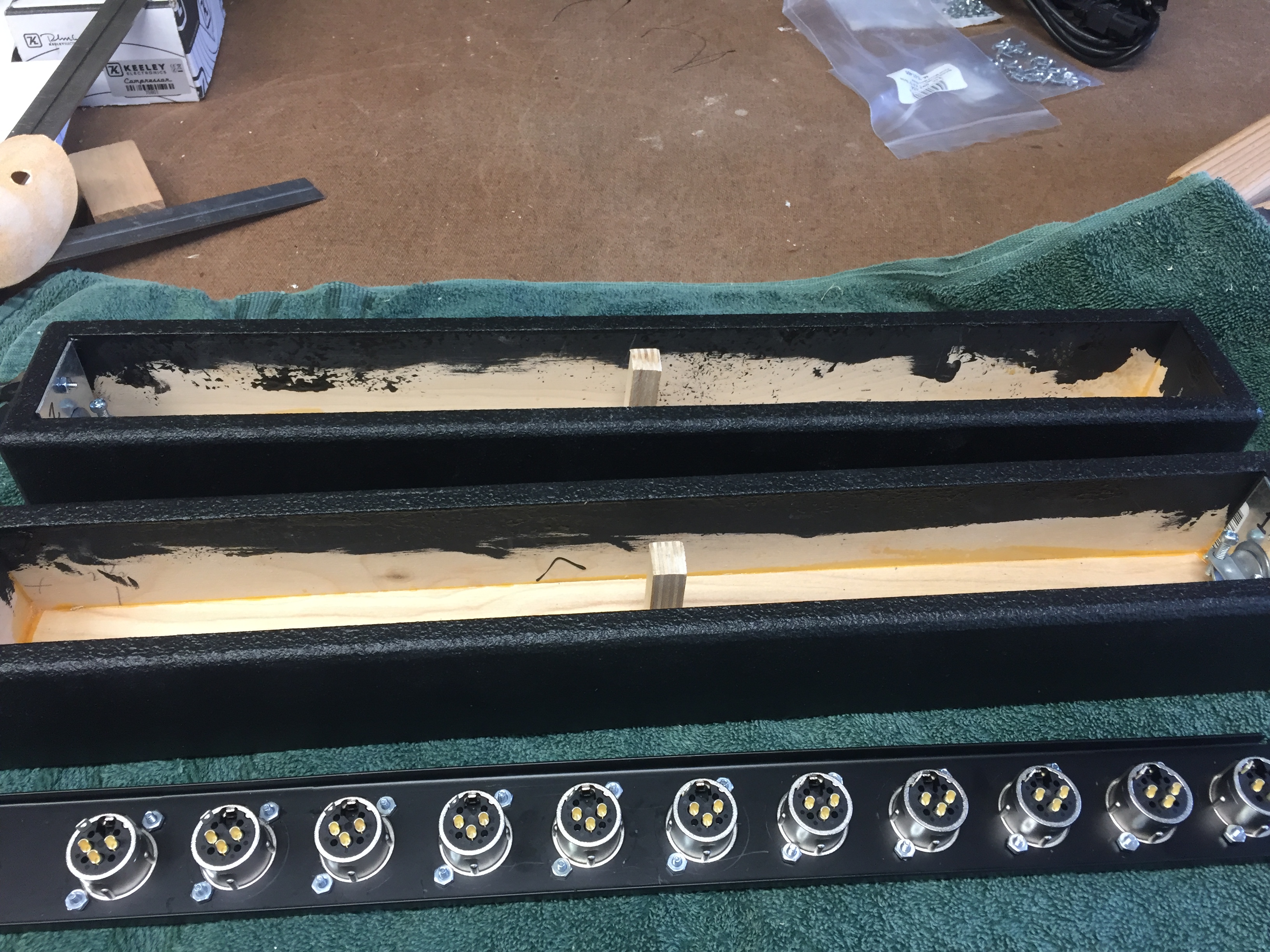

One thing I neglected to point out was there was a little flex in the panels.....I'm used to using 2U panels -they are a bit stronger.
So, I put a support block in each one to shore it up a bit.
Started wiring up the first panel today. Stripped back the snake to get some clean pairs. The quality of this 30+ year old snake is wonderful. The foil shield didn't just unwrap and fall off like the newer stuff. Actually had to cut it.
Cut all the pairs to the proper length. You'll notice that I doubled back between the third and fourth connector. I wanted plenty of room to add some heat shrink to clamp onto.
Put a little heat shrink on the end of each connector to keep the foil in place, but it probably wasn't necessary. Looks good though.
