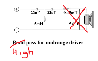

I built an Omni15 (2 12's, no tweeter) and did my best to follow the instructions to the letter. This is the first speaker cabinet I've attempted, and so far I'm very pleased with the results, but I'm not sure I've got it 100%. I've played bass through it full volume maybe 4-5 practices, and then the first issue showed up. The midrange speaker was buzzing. I figured it was breaking in and cone excursion was increasing, making contact with the baffle, so I installed a spacer ring to give some clearance, and it solved the issue. But I started to feel like the mids and highs were lacking, like it wasn't keeping up with the low end. So I ran a sine wave tone generator through it, sweeping across the frequency spectrum, expecting the mid horn to disappear around 3-500 hz, but I can hear a response all the way down to 50 Hz and lower. I'm pretty sure I wired it up correctly per the directions...omitting
the .45mH coil and 5.6uF cap, making the midrange filter a high pass. Could I have fried the crossover somehow? Maybe that's when the buzzing started, since it started playing the low frequencies? But it seems like blowing a cap would just open the circuit and no sound at all would happen through the mid speaker?

Curious about what frequency the rolloff should start attenuating low end response for the midrange...
I'm using the high pass crossover for the mid-only (no tweeter) configuration, 22uf and 33uf caps, and 5 mH inductor...

I isolated the woofer and horn sections and checked them separately by ear..no spl meter..
I believe the high pass is working as it's supposed to ...rolls off quickly around 200Hz, blocking low end as it should.

#8 Post by Bill Fitzmaurice »
It looks OK. The low pass is around 500Hz, the high pass around 300Hz. The low pass is higher than 300Hz to compensate for where the woofers are placed, which itself acts as a low pass filter. The reason you still hear them at 2kHz is due to their rising sensitivity in the mids.
