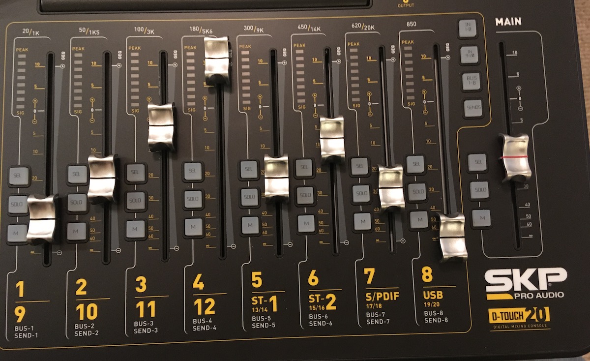

Why yes, they do fit...and quite nicely.

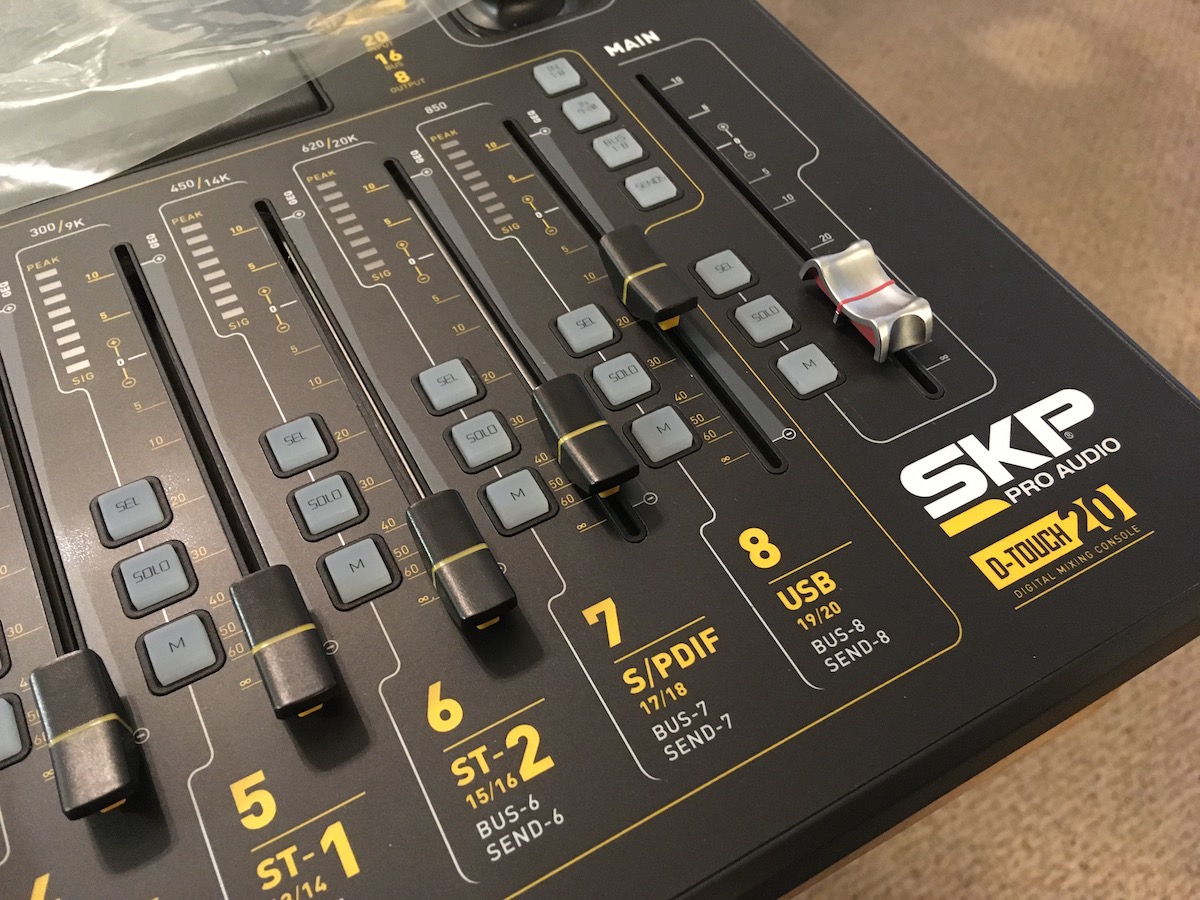

When using my mixer I noticed two things I didn't particularly like about the faders.
1. Their rounded profile makes them kind of slippery when pushed using a single-finger.
2. The black-on-black color scheme makes it difficult to see where the faders are at in low light conditions.
So I searched for a solution, and I really liked the style of knobs found on either the Yamaha CL series or above, and the Behringer X32. Once I saw a video on the CL series motorized fader maintenance, I noticed they may be the same fit as on the SKP.
Yamaha parts are really easy to order, so I sent out for eight WN980500 knobs and one WR791401. Sure enough. They have to be orientated correctly and fit very tightly, where as the SKP knobs snap into place, but the end result is much improved feel and visibility during use.
