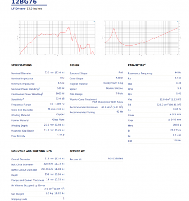

I bought these B&C 12bg76 sub drivers for my tuba 45 project, but am now beginning to second-guess if they are a good fit. We are going 16" wide, so without a hole in panel 5, I calculated the enclosure volume at 1.12 ft3. With this driver, that gives a QTC of .6 - which should be in the realm of good, tight bass, (which is what I want), with the sacrifice of a bit of efficiency (no problem I have good amp power). Also calculated the f3 at 69hz... which seems a little high...
As far as cutting the holes in panel 5 to double the enclosure volume, I hesitate to do this because when I simulate the B&C using speaker box lite, it shows the B&C hitting xmax prematurely at lower frequencies. Anyways, at this point it's really too late to do holes in panel 5, so I want to keep it in the 1.12 ft3 space (I want to do the jackplate in panel 5.
So, I'm second guessing myself because the popular lab 12 seems to have a lot less mechanical damping than the B&C. Also- I am wondering if the horn itself adds damping, thus dropping the QTC down even further.
Thanks for taking a look at the TS of this woofer and offering your opinion. At this point I'm wondering if I would be better off with the lab 12 or going for the higher-powered B&C 12bg100 and just muscling through the low QTC...

You cannot apply calculations for a direct radiating enclosure to a horn. Horns do not have Qtc.Pabloaguas wrote: ↑Mon Jan 25, 2021 1:40 am I calculated the enclosure volume at 1.12 ft3. With this driver, that gives a QTC of .6 - which should be in the realm of good, tight bass
Speaker box lite does not sim horns.when I simulate the B&C using speaker box lite, it shows the B&C hitting xmax prematurely at lower frequencies.

T45 Recommended Specs for 12" drivers / B&C 12bg76 Specs
Fs 20-50Hz / 44Hz ..............
Qts 0.25-0.50 / 0.41 ...........
Min Xmax 4.5mm / 9.5mm ....
Vas 60-125L / 32L ...............
Bill, I'm curious... what would be the effect of the low Vas? And then also not cutting the holes in panel 5 to accommodate the Fs?

Vas too low requires making the rear chamber smaller, which he has done by not having the holes.

Thanks Bill. So it sounds like the woofer will work well then?
I'm just wondering if I would gain anything by changing it out for a Lab 12? (other than gaining 10lbs)

On the surface, it seems like that driver may work out okay then. Sensitivity and extension wouldn't suffer too much?
B&C 12bg76 Vd 496cc
Lab12 Vd 658cc
Difference = 162cc in favor of the LAB12 at roughly 33% more Vd than the B&C 12bg76.
Other than an extra Vd, does the LAB12 offer enough benefit in his case to suggest purchasing a pair of LABs instead?
I'm guessing the voltage limit would be about the same with the B&C driver. But, I've got nothing to base that on other than it's reduced Xmax and increased nominal impedance compared to the LAB12.

It's more or less equivalent to the 3012LF.
