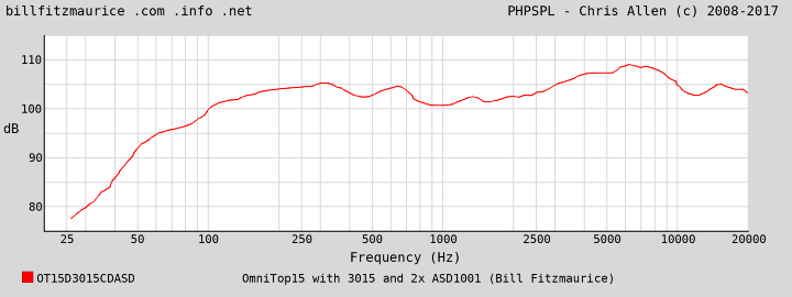

If anyone can confirm the cabinet gain being about average 5-6db over raw driver spec from 150-1000hz, I would appreciate it. Just want to ensure Im analyzing the charts correctly and apples to apples

Here's the trace for a 3015 in an OT15
