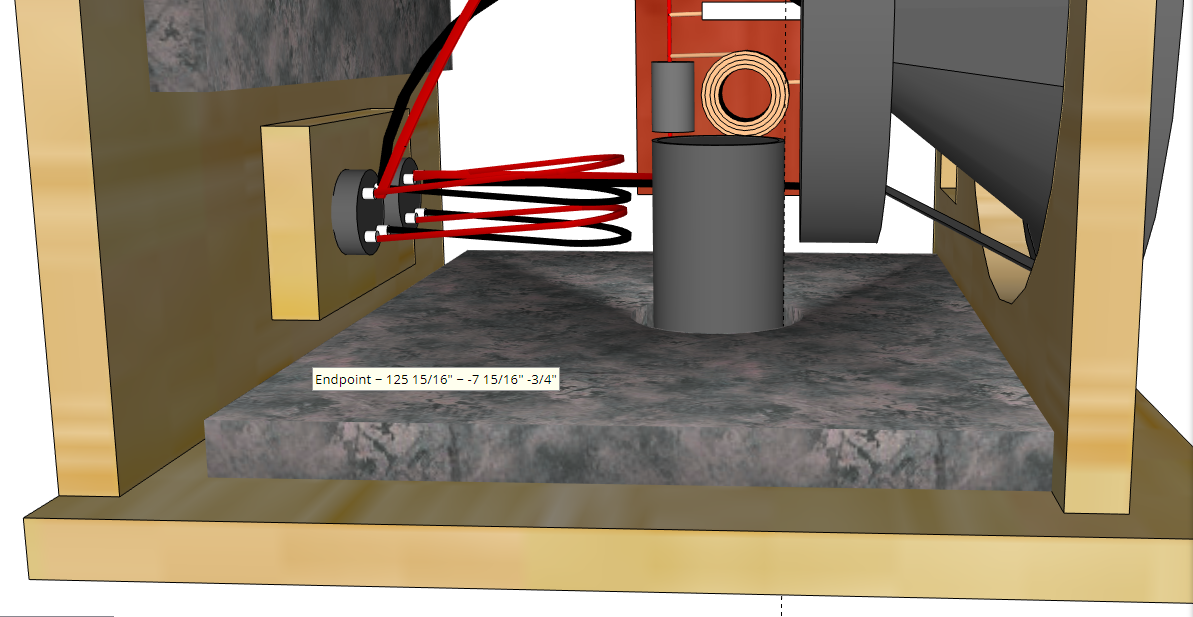

So, can any of you SLA owners tell me how much of an offset you used on locating the TopHat toward the front of the cab? Obviously the drivers will make it a little front heavy. Probably not a whole lot since the magnets are back a little and the baffle is set back, but I'm guessing an inch would do it. Or, did ya' just put it in the middle? And if so, does it want to lean?
Re: SLA Pro - Powered
My plans had the holes offset already so I just used what Bill spec'd out. Like a 1/2" inch or so. Still ended up with cabs that are more forward heavy, but that's entirely do to the Alphalites which have their C.O.G. very close to the top plate vs. the ferrite magnet Alphas.
The center of the top hat's (top and botom) in my 2x6's are 4½" from the front, like it shows on page 11. Haven't noticed anything one way or the other about the location and weight distribution. It's just fine with either configuration, single cab or double stacked.Bruce Weldy wrote: ↑Tue Nov 24, 2020 3:50 pm So, can any of you SLA owners tell me how much of an offset you used on locating the TopHat toward the front of the cab? Obviously the drivers will make it a little front heavy. Probably not a whole lot since the magnets are back a little and the baffle is set back, but I'm guessing an inch would do it. Or, did ya' just put it in the middle? And if so, does it want to lean?

Yeah, the offset in the plans is only 1/4" forward....doesn't seem like enough. But, I guess forward heavy is better than backward.

It'll probably be fine anywhere from the plans location to a little more forward. I plan to put the crossover behind it, so I'll probably move it forward a bit more.SethRocksYou wrote: ↑Tue Nov 24, 2020 5:22 pmThe center of the top hat's (top and botom) in my 2x6's are 4½" from the front, like it shows on page 11. Haven't noticed anything one way or the other about the location and weight distribution. It's just fine with either configuration, single cab or double stacked.Bruce Weldy wrote: ↑Tue Nov 24, 2020 3:50 pm So, can any of you SLA owners tell me how much of an offset you used on locating the TopHat toward the front of the cab? Obviously the drivers will make it a little front heavy. Probably not a whole lot since the magnets are back a little and the baffle is set back, but I'm guessing an inch would do it. Or, did ya' just put it in the middle? And if so, does it want to lean?
Looking at the SketchUp, there's not a whole lot of room to move forward, 3/16" between the Top Hat and the driver. Not sure how accurate the driver and top hat dimensions are to actual. If you're gonna move it forward from where the plans dictate, you might want to get a driver in there and measure before making holes.Bruce Weldy wrote: ↑Tue Nov 24, 2020 5:48 pm It'll probably be fine anywhere from the plans location to a little more forward. I plan to put the crossover behind it, so I'll probably move it forward a bit more.
- Posts: 8664
Oh, I won't make hole until the drivers get here...or at least until I do some major measuring. I can get the depth specs off the Eminence site. But, with the baffle setback, there may not be much room to pull it forward.SethRocksYou wrote: ↑Tue Nov 24, 2020 6:28 pm If you're gonna move it forward from where the plans dictate, you might want to get a driver in there and measure before making holes.
