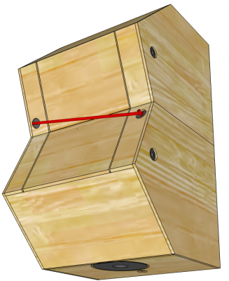

Here's what I'm trying to do.
Just a little jumper from one cab to the other when they're stacked.
The combo SpeakOn/¼" jacks are out of the picture, won't work for what I plan. It's a 2 pole plug, and the signal I want on it will be from connections 3&4 from a 4 pole plug. And, from the description, a 4 pole plug will fit in it. On a system wired with subs on the first pair, it could cause trouble if anything other than a jumper got plugged in there. So, that option is out unless I fill in the outer ring with resin and effectively disable the SpeakOn option, making it a ¼" plug only... which is an option and would be fine with me.
Just using standard 4 pole SpeakOn's is an option. It does keep continuity in the wiring scheme and wouldn't be too much trouble to create a jumper solution if I misplaced the actual jumper made for the purpose. I'd want to have 90º ends on the jumper and might have to add extra slack in the wire to allow the connector room to turn when inserting and removing it. Obviously, would have the top of the jack toward the outside of the cab.
I'll have to let some of those options roll around in my mind a bit. I'm still leaning toward the ¼" plug option and interested in at least identifying a workable jack for the purpose. So, please keep the recommendations coming guys.

There's a reason that 1/4" jacks have gone the way of the dodo when it comes to Pro sound....the speakons just are so much better. Can't easily pull one out like a 1/4" plug. All cables are standard through out the whole setup, etc.
I carry some Speakon to 1/4" adapters for emergencies.....typically a bass rig where the bass player forgot his speakon cable or brings a borrowed cab and didn't realize it was speakon.
If you just have to have 1/4", you could use a standard jack and build a little dog house around it on the inside of the cab with just the wire coming out....that's easy to seal.

A two-pole jack won't accept a 4-pole plug, but a four pole jack will accept a 2-pole plug. What about using binding posts that will take a banana plug? They seal nicely. I did that on the truck tuba I just built. I cut a rectangular hole in the cab, backed it with a piece of BB and drilled the two holes through that for the binding posts. This allowed it to be recessed so it doesn't get whacked. Then you'd just need a little jumper with a banana on each end.

Ehhhhh, I think that'll be a little too "non pro" for what I'm intending. I'm really starting to lean more toward your initial recommendation of staying with 4 conductor SpeakOn's.
In my mind the ¼" plug option seemed clean, simple, and easy to use. But you're right... last thing I need is for some idiot to plug his guitar or headphones in there.
