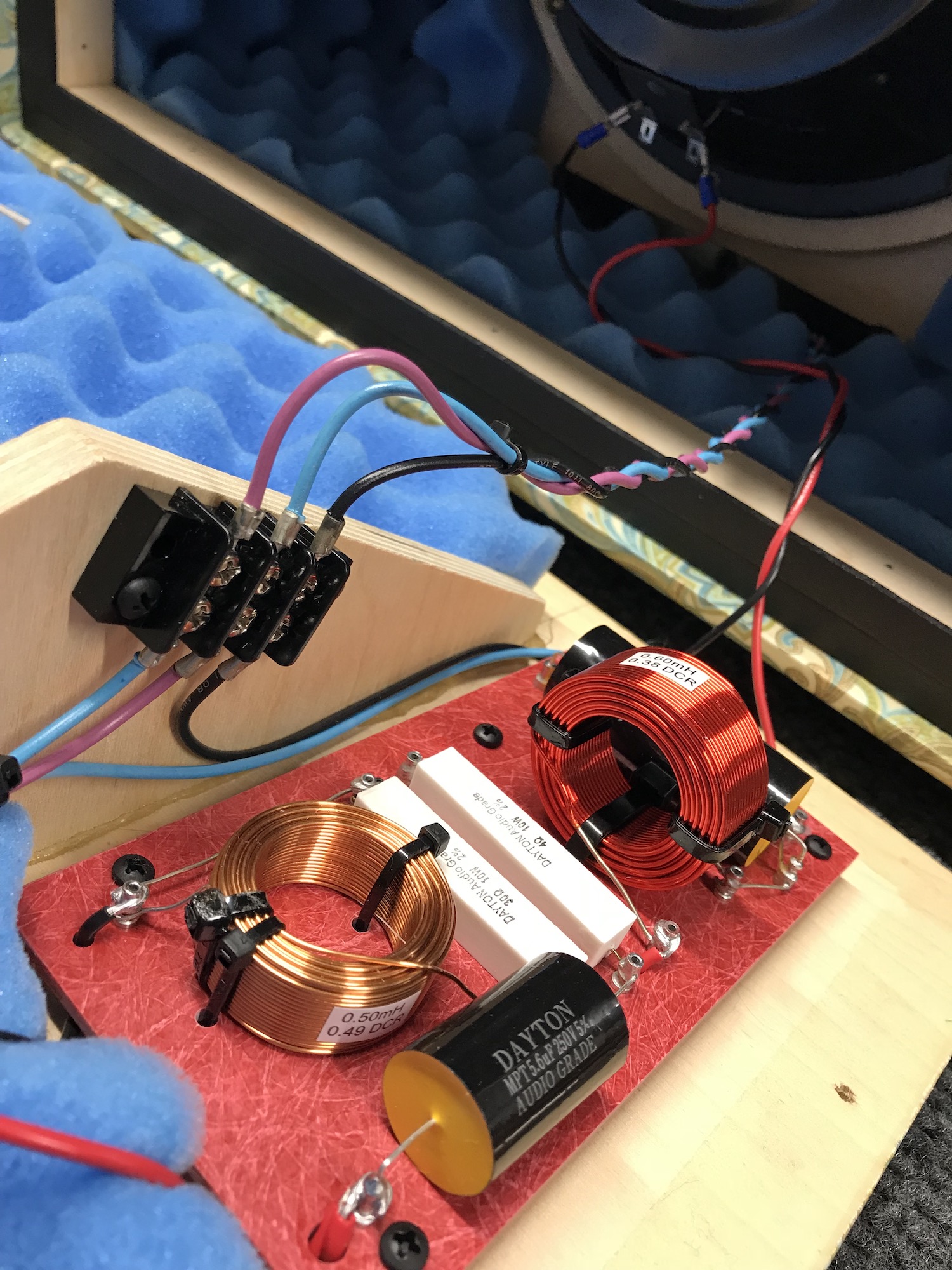

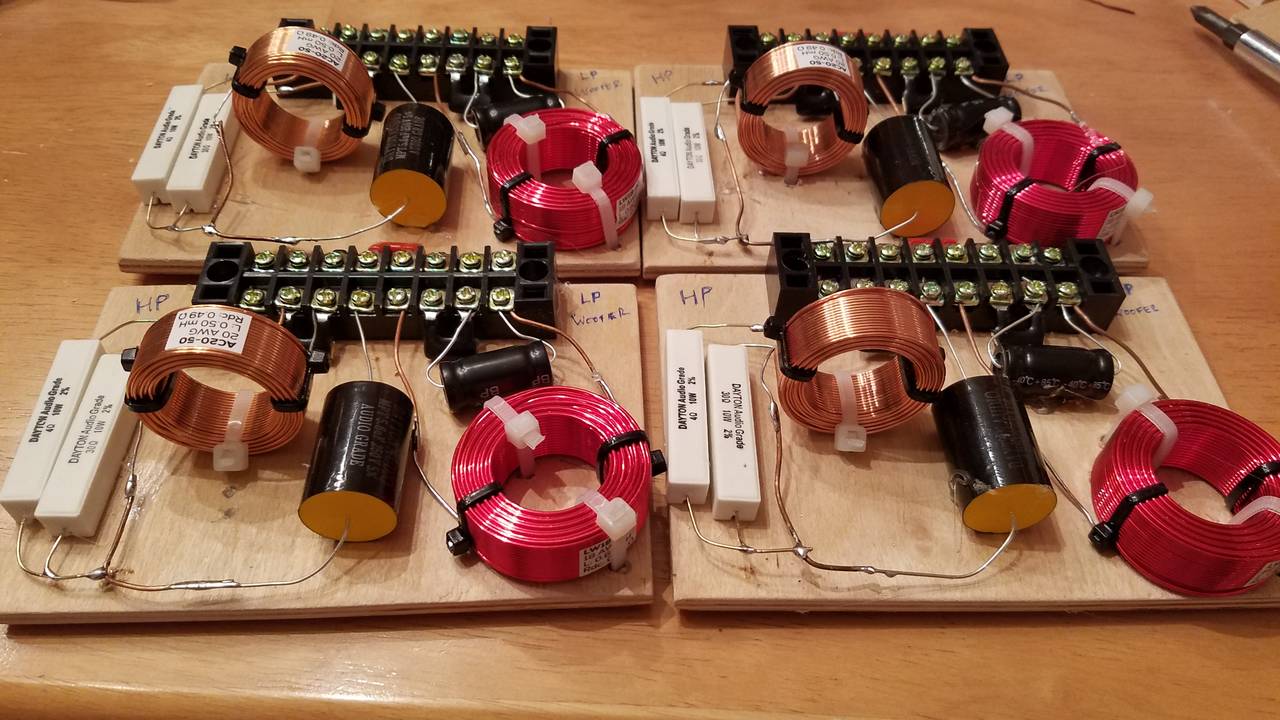

I used terminal blocks when I built mine for my j-arrays, assuming jack x-overs would be similar. Was real happy with how they turned out and minimizes the soldering. I have a pic in my build thread - not sure the hyperlink is pasting in correctly - but you can search for it under Otop Jarray build. I used zip ties and hot glue, and I think maybe even some PL for extra hold.
download/file.php?id=13332&mode=view

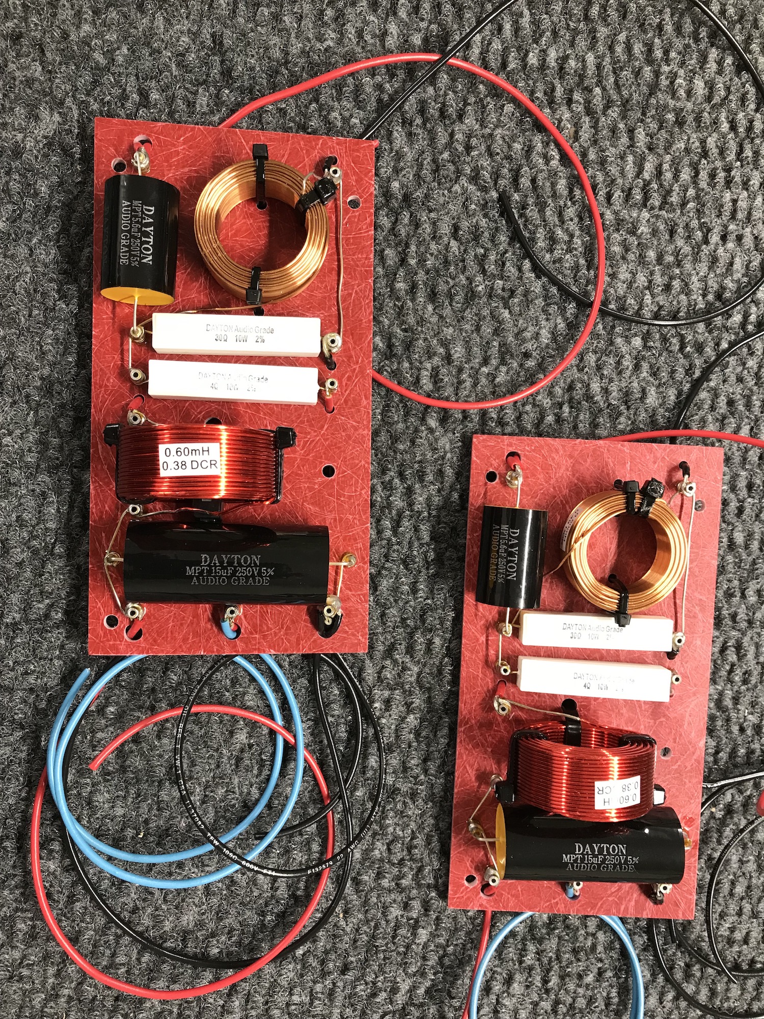

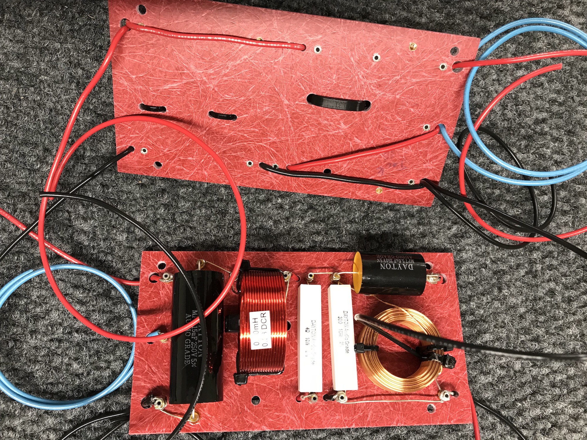

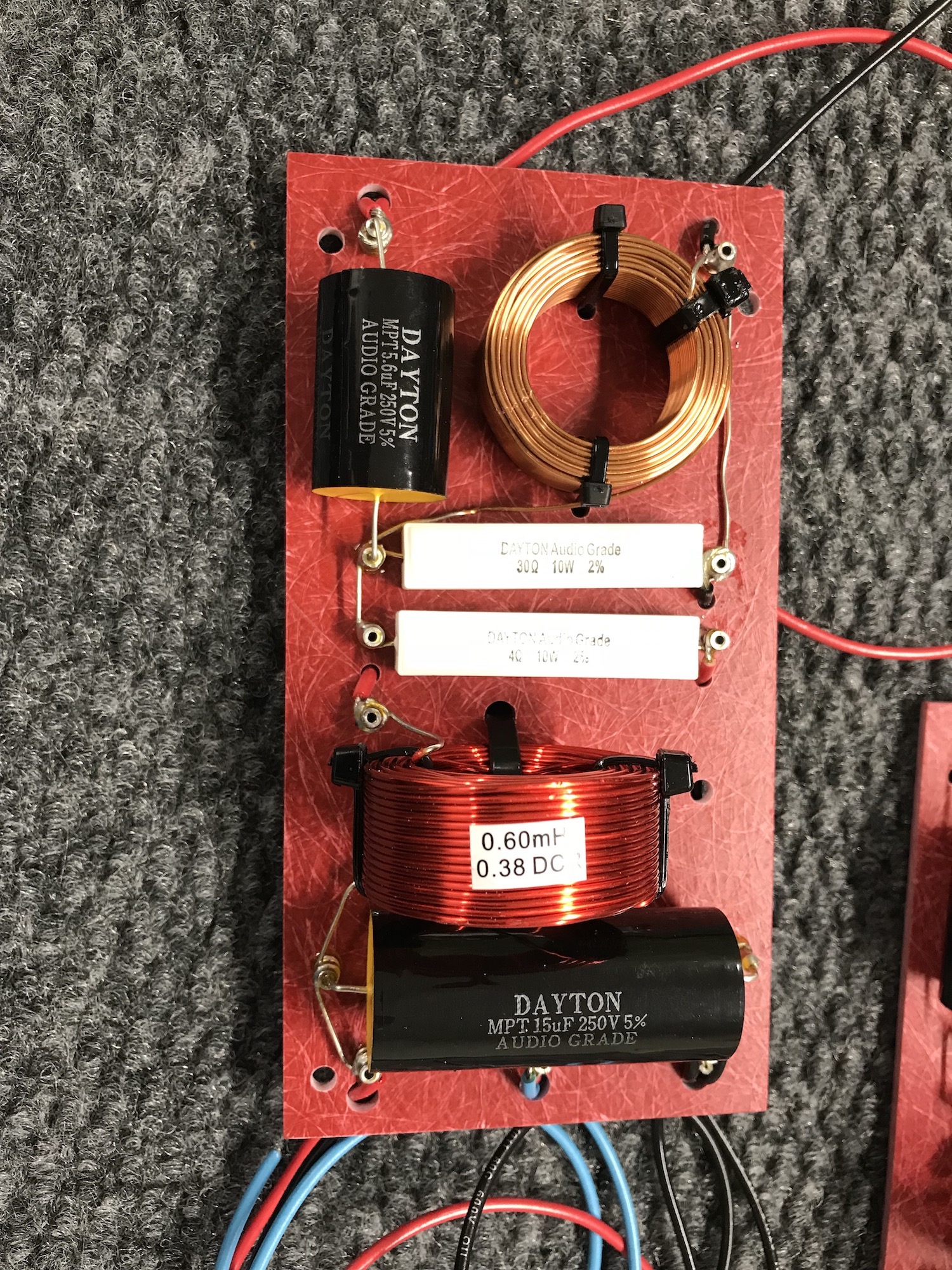

I used turret board construction since I build tube amps once in a while. These are from my Jack 10's.
Definitely wire ties for the heavy items.
