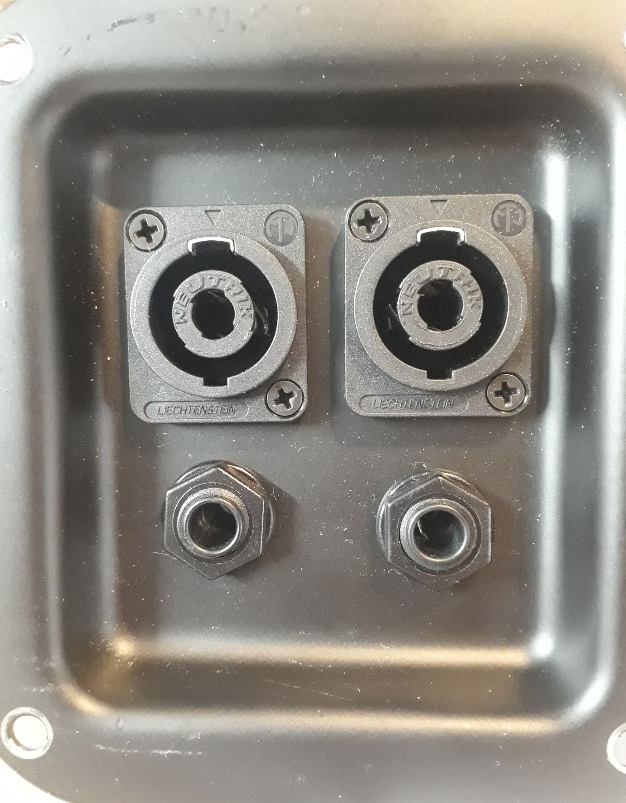

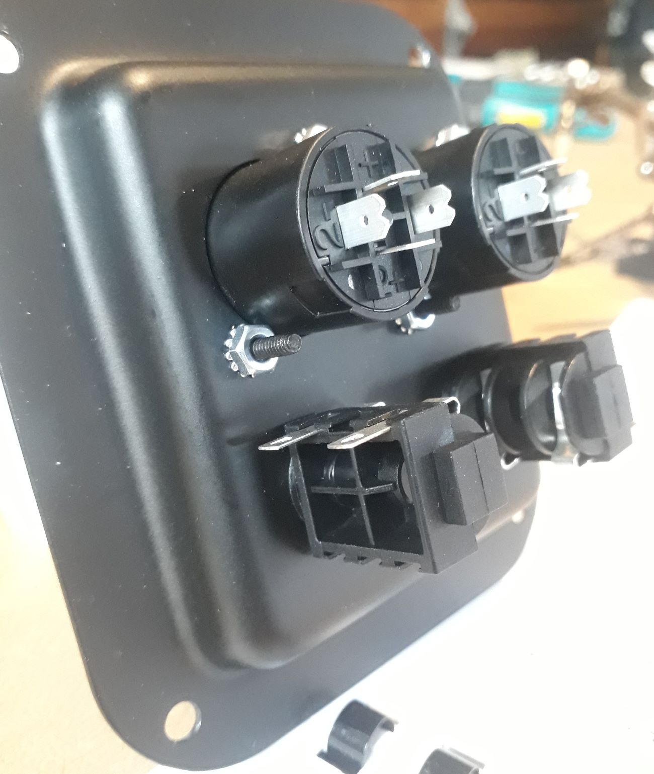

Anyway, I'm asking for confimation how to correctly gang wire my 4 way Speakon & T/S input panel please so I have all options covered. I have little plastic blanking jack plugs from Leland for the T/S's when I'm only using the N/4's.
Photo's attached.
Firstly, I'm thunkng:
a. Looking at the full rear pic, Neutrik Left is just paralled from +1 sideways over to +1 on Neutrik Right.
b. Then, Ntk -1 Left goes over to -1 Right; so that's them both done then.
b. Then, and this is the part that I'm not 100% on. Left Each Neutrik is paralled down +1 to Tip and -1 to -1 for the sleeve. On the T/S, which terminal is which?? I can't see any marks.
Would someone please confirm or deny or correct me.
Thanks in advance.
Cheers :feedback:

Tip on the TS is "hot" or +, in other words the lug nearest you in the pic(s) when looking from the back...
Posts: 7569
Re: NEW BUILD - Omni 15 Tall Boy in New Zealand
#108 Post by Tom Smit »
When you grab a 1/4" plug, the end nub is the tip, and the long part/shaft is the sleeve. Now, when you look at the connector, you can imagine that the tip goes all the way in, which would mean that the end of the connector is for the tip. As Grant pointed out, the Tip is +ve, which makes the sleeve -ve.
