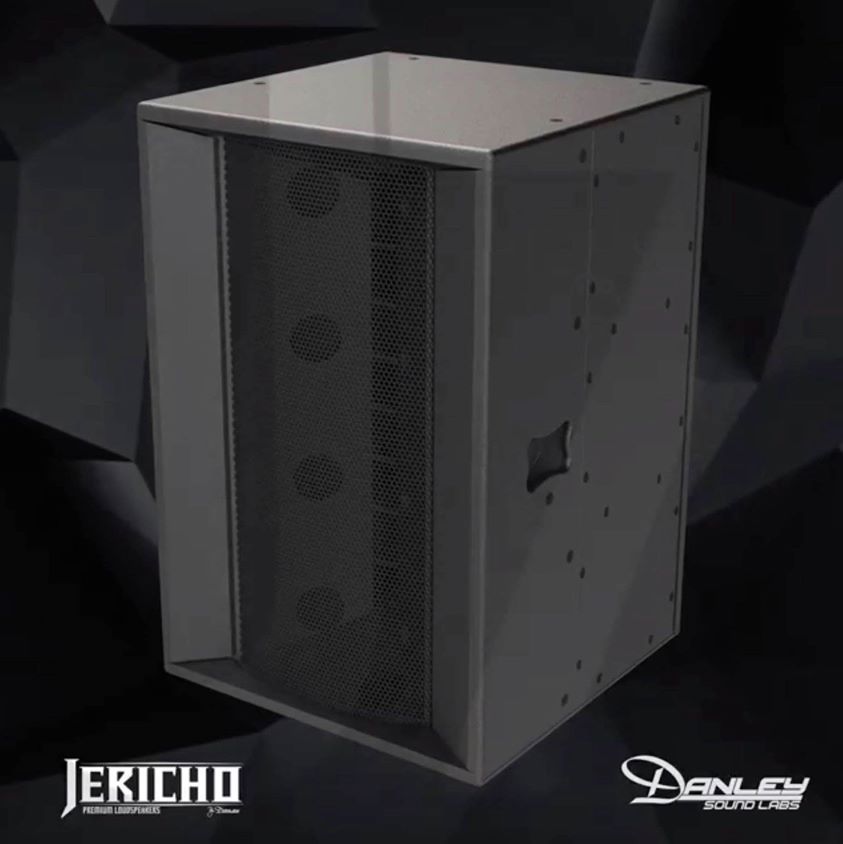

#24 Post by AcousticScience »
KyferEz wrote: Mon May 25, 2020 1:22 pm I want each channel capable of hopefully 140db+ from 80hz up at about 10' away.
In that case you'll need 5 of these:
Your ears will quickly give up the ghost though from trying to reproduce the sound level of a firework rocket that flew in through the window. And I thought I was crazy running Omnitop 12 in my room! I mean a Marshall stack is "only" 125dB
