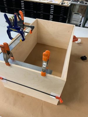

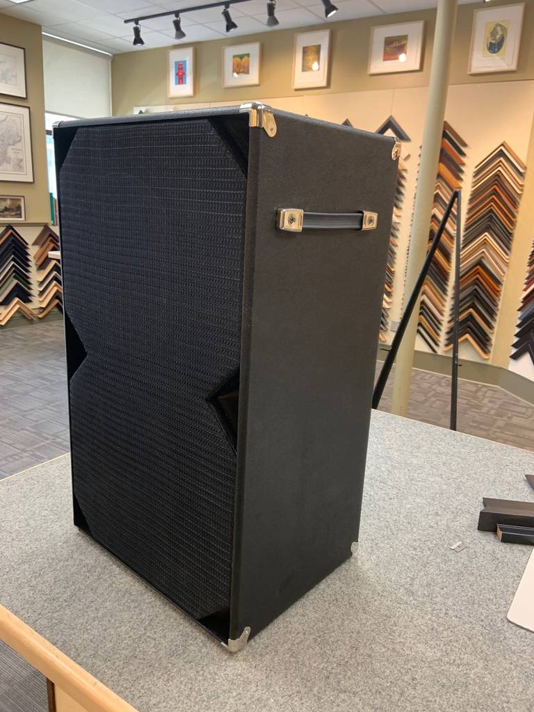

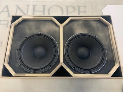

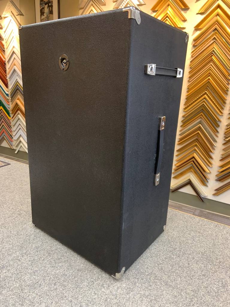

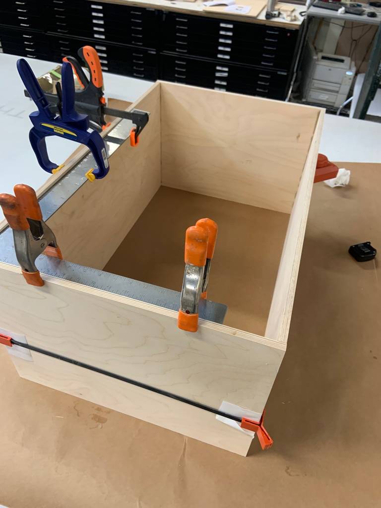

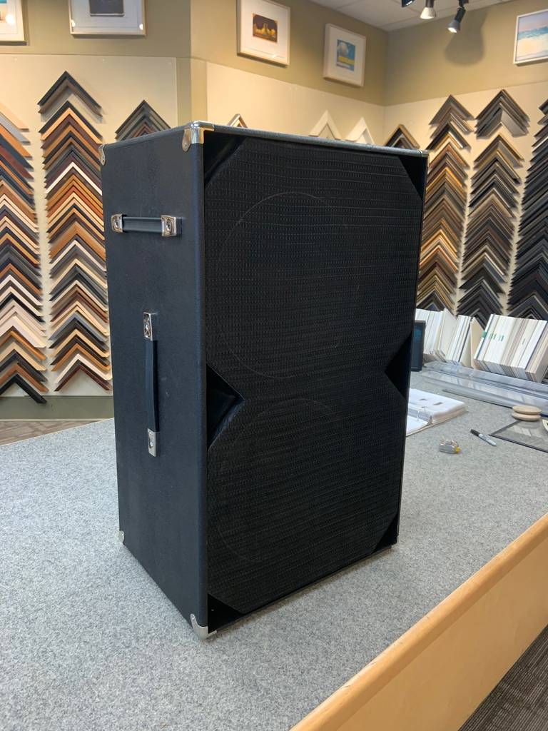

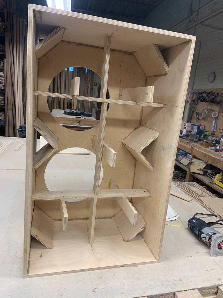

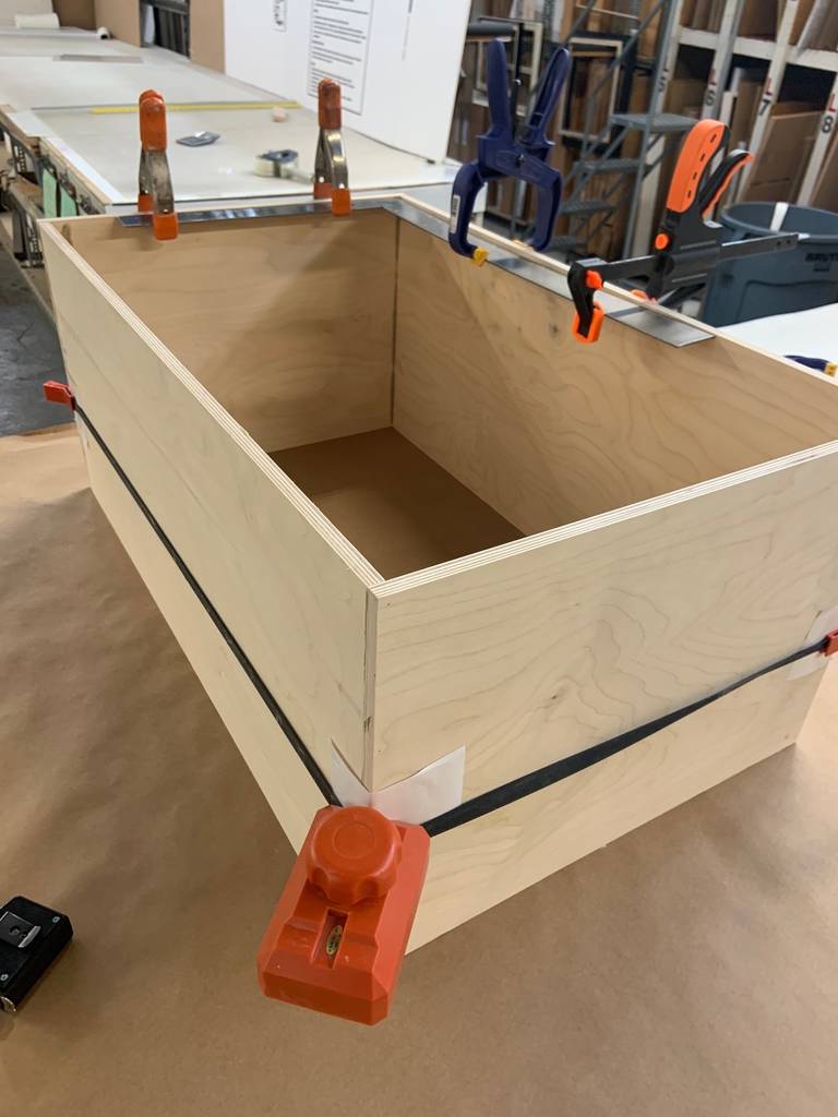

First build. A Simplexx 212 from a Speaker Hardware flat pack w/ 3012HO drivers. It was a lot of fun to build. The one big mistake I made was not following the plans and using T Nuts for the speaker mounts. A couple stripped but hopefully it won't cause too many issues. 55 lbs.

I learned my lesson and won’t use them again. The T nuts stripped the surrounding wood and just spin. Just plugged it in and it sounds fantastic. Much more lively sounding than the pair of SVT 112AVs I have been using.
