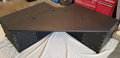

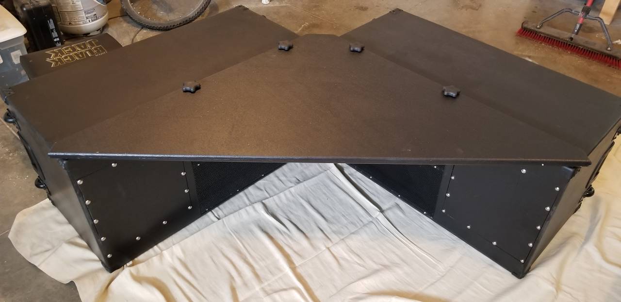

To put a pretty bow on everything, I did the finish work on the V plates this weekend. They look pretty wicked.
Bruce, I did not want to put holes in my subs but the grills made your method impossible for me. Instead, I used 1/4-20 EZ-Lok threaded inserts and they look good. Then I got some 1/4-20 hand knobs on Amazon and voila!

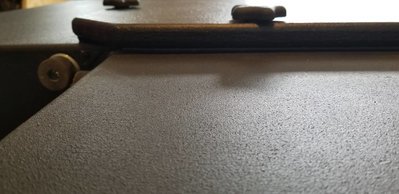

Rounded off the edges and applied Duratex yesterday. Did a final fitment today and couldn't be happier with the form/fit/function.
Finally, I used that rubber seal material Bruce suggested from Home Depot. Worked like a charm and I see no issues with it sticking to the Duratex. Thank you for that.
This should bring the T39 project to a close for now. And here I was thinking I'd keep myself busy pretty much until I left for Turkey but this stupid virus has the DoD pushing back all travel for at least 60 days, maybe more. Now to find something else to occupy myself with until then......
