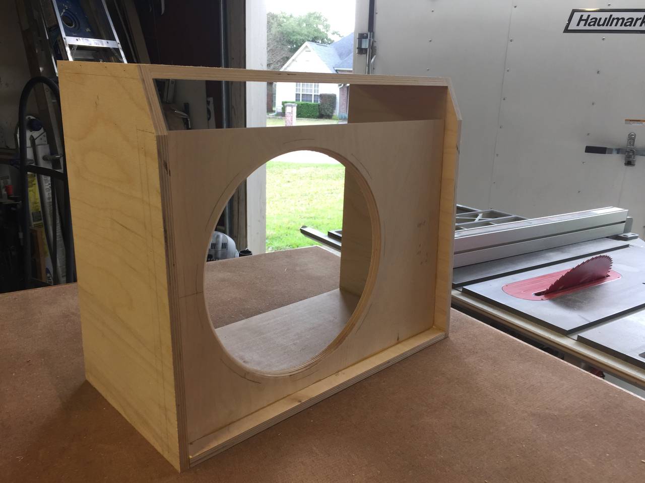

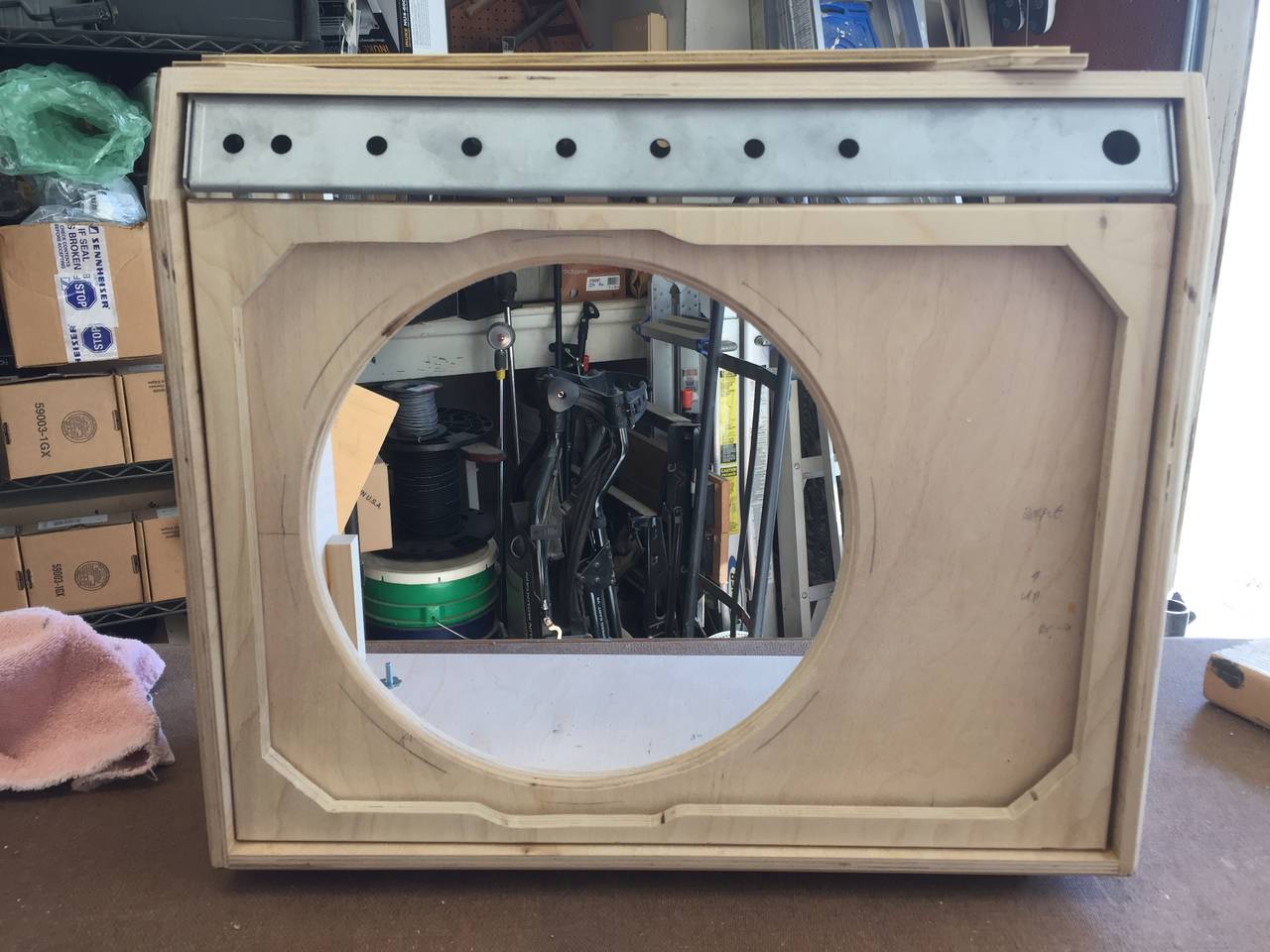

Pieces are cut out along with the baffle. I'm going with a 12 in. driver even though the standard Princeton has a 10. There's room for a 12 with no change in the cab size.
To keep everything lined up, I used biscuits. As you can see, I'm using 1/2" BB instead of 3/4 Pine. Trying to keep it light....although I'm not sure that the BB isn't as heavy as the solid pine. Anyway, I had BB scraps - so that's what's happening!
Used the trusty corner braces to keep it squared up. Best 10 minutes I ever spent building these.
All put together....you'll notice that the top overhangs the sides. I made the angle cut to the front and put the cab together first.
After that was dry, I set the angle on the table saw and made the final cut to the front face on the entire cabinet at once.

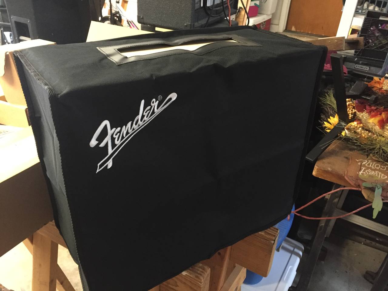

The good news is that the cover fit!

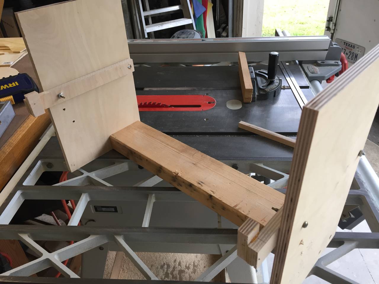

While I was there, he showed me the 5E3 amp that he was building. He had build a cool little jig that holds the chassis while soldering. And it was adjustable to find the right angle. I thought that was a great idea, so while I was doing woodworking, I cobbled one together pretty quickly....it's down and dirty, but it will be really valuable while putting the electronics together. It could have been prettier, but I doubt it will ever get used again....

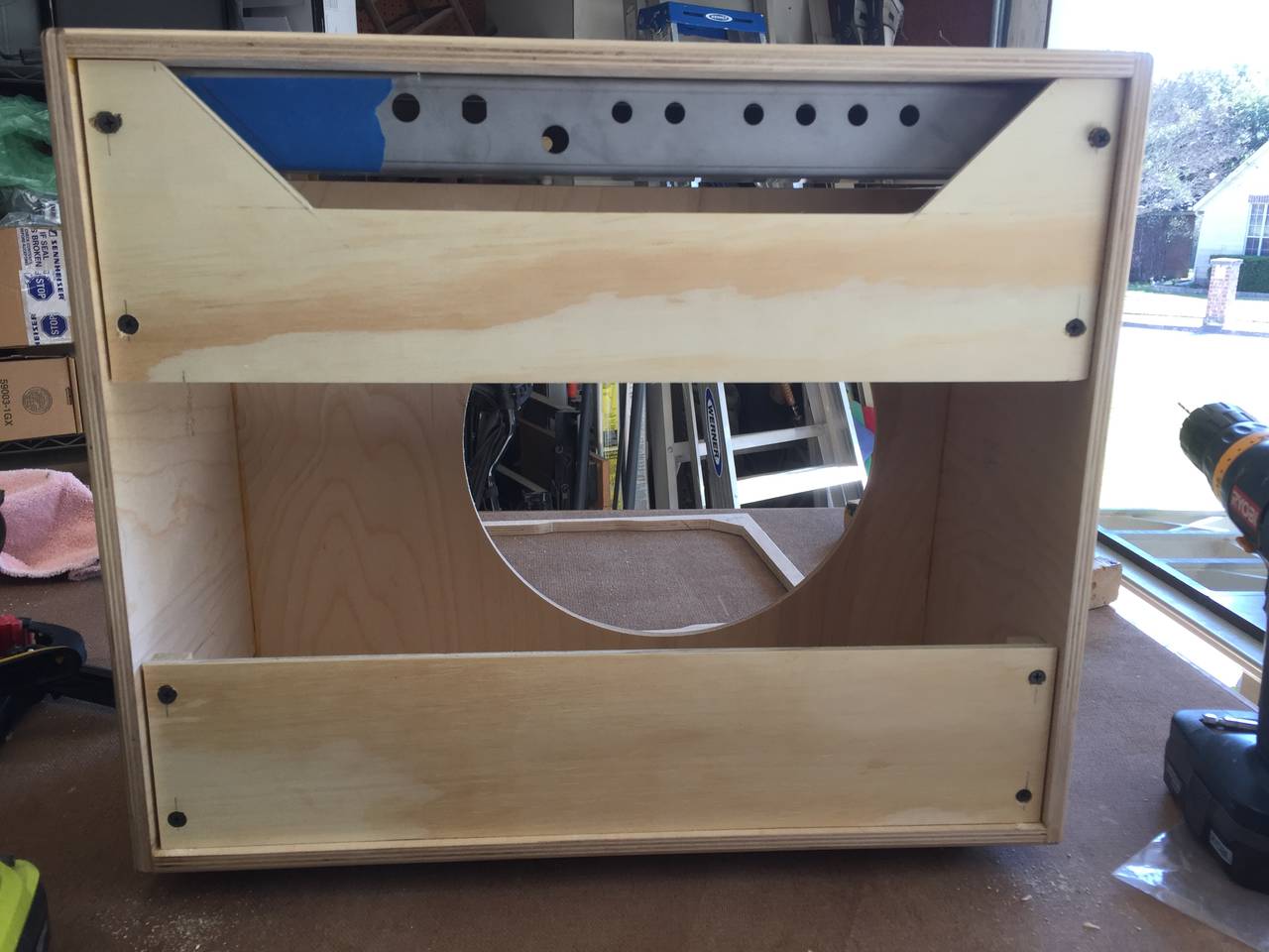

Decided to completely finish the case so I can concentrate on the amp build. Got the chassis lined up and mounted to make sure everything was right.
Tired of having feet come loose or spin when you tighten 'em, so I used T-nuts on the feet.....
Started the grill frame by doing a rising cut on the table saw. Went ahead and routed the edges at this point before I finished the cuts.
Finished the frame with the jigsaw and added a top and bottom cutout to make room for the speaker..
Installed the back panels ......

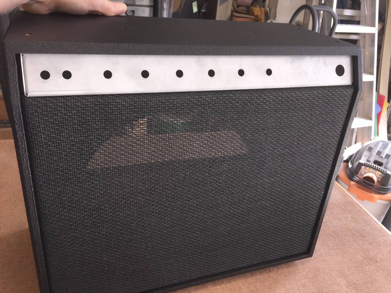

Now it's time for the dreaded grill cloth..... I used a piece of leftover grill cloth from my Boogie combo build a couple of years ago. It just barely was wide enough. It's important to keep a nice straight line along the weave so it doesn't look crooked when it's installed.
The real test though was whether it would fit snugly in the cab and fit under the chassis.....
Pulled out the chassis, put on the feet and set it aside until the speaker comes in tomorrow....

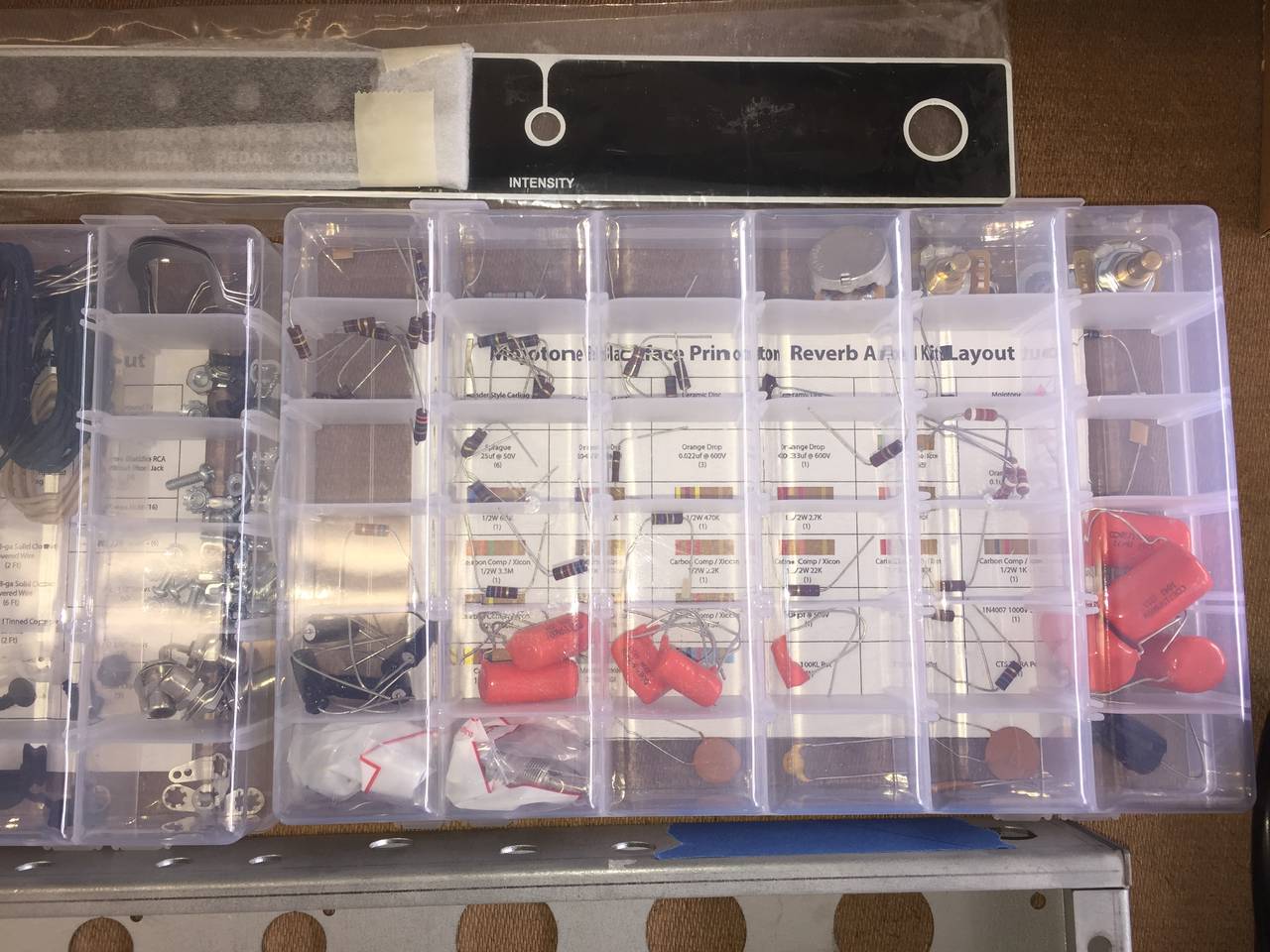

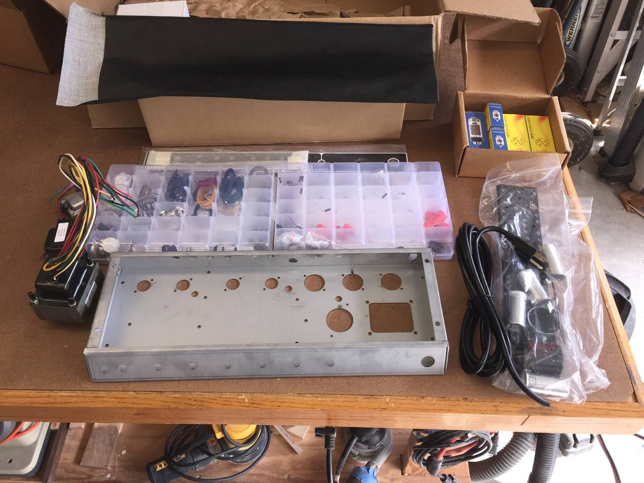

Lot and lots of pieces...every one of those little compartments in those plastic cases had something in it. Along with some bags and boxes of stuff.
