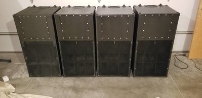

Alright, fellas. Got my driver's in a day early and broke them in overnight. Loaded them in the cabs and buttoned them up.
I got a cheap SPL meter and I'll make some noise on Saturday. I look forward to taking lots of notes and sharing my thoughts.
BTW, on the first cab the grill and driver cover mounting scheme and the mouth braces are a bit different. Didn't quite know how I wanted to do things when I started.
Re: Titan 39 Build
That's so great Bryan
I'm excited and anxious to hear your impression.
Re: Titan 39 Build
Thanks, Seth. I'm fairly anxious as well. I started this endeavor in 2015-2016 I think and I'm finally finished with my first goal. I definitely look forward to testing the tops and subs together. I'll be like a kid in a candy store for 12 hours or more.SethRocksYou wrote: ↑Thu Jan 30, 2020 9:39 pm That's so great BryanI'm excited and anxious to hear your impression.
Re: Titan 39 Build
Any idea what they weigh?
Re: Titan 39 Build
I haven't weighed them yet. I don't think they weigh more than 70 lbs, though. They're surprisingly light. But that's one data point I plan to get this weekend.
Re: Titan 39 Build
Great to see Bryan...
