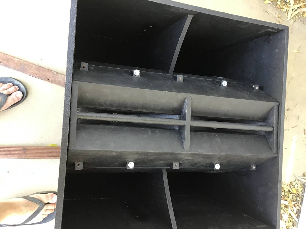

Things are progressing.
The 2 new cabs have been up to the horn sheaths on, just before Christmas.
One module has been completed, including nacelles, though I'm going to look at revisiting the nacelles I put on, as a couple have cracked while drilling.
I have an idea about using some different material to make them, and if it pans out, I'll share.
Regarding the nacelles, when I built the first pair, I could not fathom what was in the plans when compared to the result in sketchup.
A light bulb moment on this build; the nacelle is the only three dimensional image in the entire plans.
Suddenly they made sense...

Progress and proof lol.
Waiting on some inductors to complete the filters.
Then cab 1 can be sealed up.
Cab 1 weighs about 48 pounds. These "feel" heavier than the melded array versions.
Cab 2 is painted, yet to finish module, then both will get a grille with foam backing.

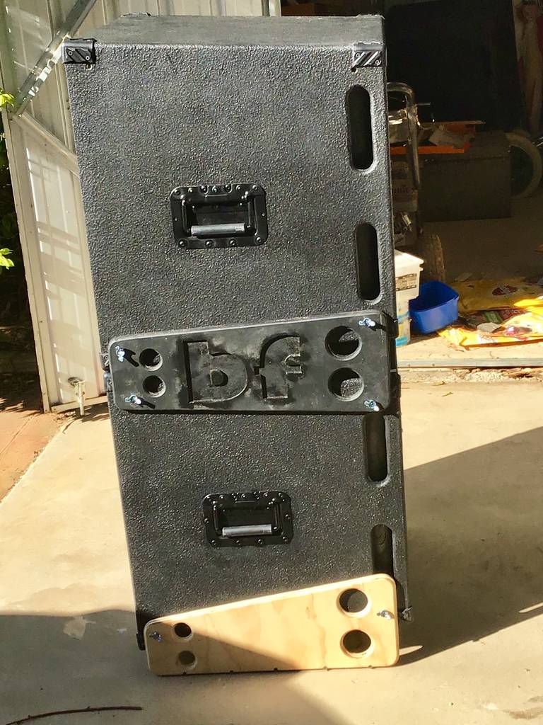

Those look really good Grant! I wish I put side handles on mine. What kind of CD did you go with?
Re: 2 x DR250 build (melded) March 2012 plans. Beginning 2 more...
#173 Post by Grant Bunter »
CoronaOperator wrote: Thu Oct 03, 2019 11:13 pm Those look really good Grant! I wish I put side handles on mine. What kind of CD did you go with?
Thanks CO,
I’ve gone with some locally available bolt ons, 80W handling.
ASD 1001B’s aren’t available locally!
The handles are also local, and are only 3/8” deep, so I routed out a bed for them and no hole in the inside either 🙂
Oh and for those who haven't thought of it, the handles are put in with pop rivets, just like one would with a road case...

#175 Post by Grant Bunter »
A little more progress, getting closer.
The original pair needed matching up, and retrofitting T nuts for the brackets.
They got a recoat as well.
