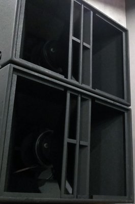

Finally we finished our 4x OTop 12 (Delta Pro 12A + PSD2013). My first impression is:

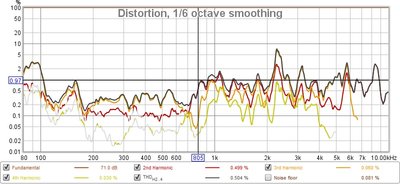

3. Delta Pro 12A in this cab is really good performer. Measured THD under 800Hz is awesome. It is mostly under 0.3% at 95dB SPL @1m. It throws really good mid and upper bass, super tight, punchy and LOUD. The ONLY downside of this driver is the weight. It is really heavy for a thin guy like me. The measured level in REW showed around 70dB, however, it is not. In room, we used calibrated SPL meter to check 95dBC Slow reading. The REW data read lower SPL because we reduced mic input gain.
4. The THD of PSD2013 is ok. It is under 1% >800Hz at the same measured condition (I used umik-1 calibrated by CrossSpectrum Lab). I believe this CD is better than that. But I dont know why THD is that high for just 95dB SPL @1m. It makes OT12 sound overly bright when drove at insane in-room level. I guess a tilted-down frequency response will make it less distort and more easy on the ears. And this CD is HEAVY, too.
I think the higher THD from 800Hz and up is the result of 1.2kHz XO with not steep enough filter. If I run this setup by DSP XO, I will use at least LR4 for CD and pad the level of PSD2013 a bit so it will not stressed under high SPL

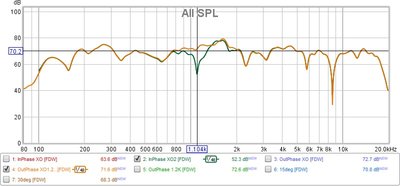

5. The polarity with this setup should be connected in reversed. We confirmed it with both measurement and listening. After reversed polarity, the mid is richer and fuller. The deep around 1k2 is no longer appeared. So we guessed that we did right thing.
6. The measured frequency response is affected by the room. We dont have luxury of measure it outdoor. However, the room is heavily treated, which is used for flushmounted main monitors. So the frontwall is hard surface. The frequency response showed the dip created by SBIR effect by front wall. Apart from front wall, the treatment eliminates almost any reflections and room mode down to 30Hz. Thus, the frequency response from 500Hz and up can be trusted.

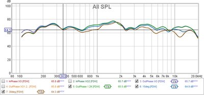

7. Power Response: The power response of OT12 (measured at 1m OnAxis, 15 Degree, 30 Degree) is good. It showed the controlled directivity behavior down to 360Hz which is really good. With 2 OT12 for each side, the horizontal projection is even better. The power response measurement is for 1 OT12.
8. EQ Suggestion: For the best result considering THD, even Power Response, frequency response and listening exprience, I used 3 gentle cut filters at around 1.6, 4.1 and 12.5 kHz. After those 3 basic filter, OT12 REALLY sound awesome.
9. One more thing I want to add: the side port. When I listened to music standing near the rear of OT12s, I can hear the mid pretty easy. I think it is the result of side port. Should it be the potential feedback problem when we use it in relatively small to medium indoor show? At those situation, we dont have much choice to place OT12s far enough from stage, so I am really worry about feedback right now.

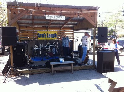

I'd say we did 25-30 shows on a stage that was only 15 feet wide with the speakers tucked right up against the stage. Not kidding when I say that my mic was only a few feet away from the port.Symphonicmind wrote: ↑Tue Aug 13, 2019 11:08 pmThank you, how far the OT from the stage edge? and How wide was the stage?Bruce Weldy wrote: Not enough fingers and toes on this forum to count the number of shows I've done with the ports of two OT12s being 4 or 5 feet away from my vocal mic......it ain't a problem.
Here's a pic of that stage - it's a tight little place....
I wouldn't worry about feedback from those side ports - you are 100 times more apt to get feedback from your monitors.
