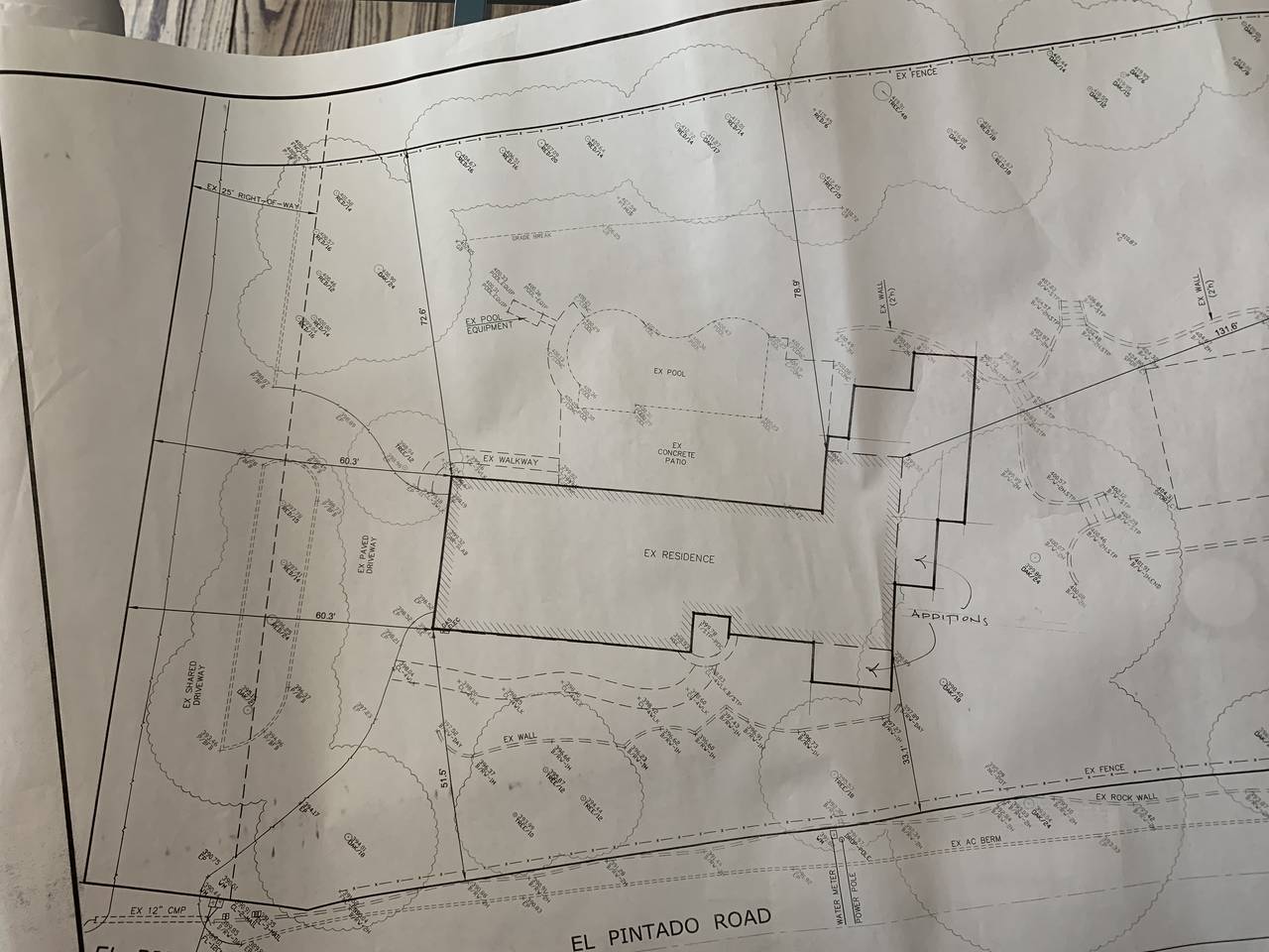

I’ve got a backyard patio where I would like a very wide near field dispersion yet also have power to reach the far end of the listening area at full range. I want to mount all the speakers under the eaves.
There is a swimming pool 20’ away from the house and a patio area beyond the pool With seating approx 50’ from the house. The width of the area is 75’ or so.
I believe the SLA curve will do great for the near field dispersion and the truck tuba will fit into the eaves nicely as well. Is there an option to install higher power drivers in the SLA for occasional higher listening levels? We generally will keep the volume low to permit conversation. At this low volume I really want a strong full range, so I believe the truck tuba will suffice even though there will be no cabin effect.
I am contemplating mounting two truck tubas wide for a stereo effect in the low range. Placing them over 50’ wide is no problem. I want to place the mid/high speakers approx 25’ apart so there is relatively even sound across the near patio
Thanks for any ideas or suggestions

I currently have a pair of Klipsch AW-650 mounted approx 25’ apart horizontally. They sound just ok when one stands directly in front of them and for stereo they start to sound ok around 20’ out. The low response is absent and in fact at the low/mid range they sound pretty bad.
I feel like even if I put a pair of SLA pro 2x4 at each position and angle them in I will see an improved near field dispersion and obviously better overall range. Add the truck tubas for bottom end
I would be very happy if the near field can be improved. At the pool and beyond is not so important.
I will experiment with mono vs stereo after installation and evaluate which is preferred.
