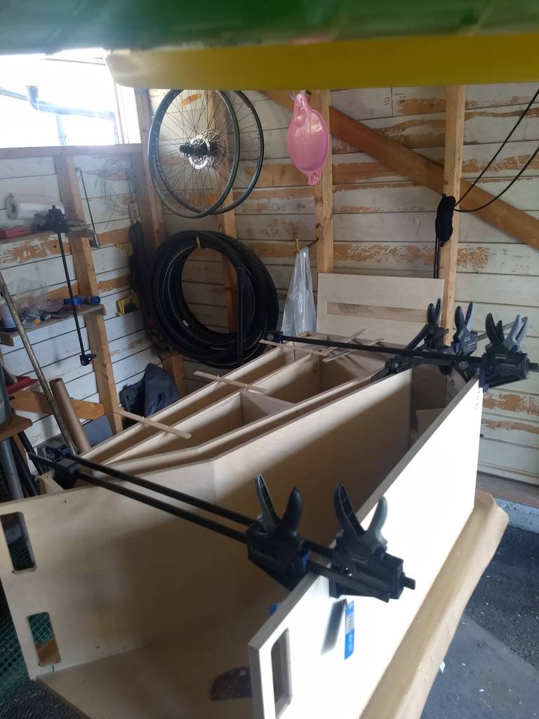

But putting in the wires and tscrews for the wheels had been easier without the last side panel on :)

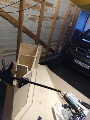

finaly started on number two :)
the experiences from the first buld helps a lot and makes things go together a lot faster without getting glue everywhere. Just have to wait on the panels to dry and continue tomorrow if time permits.

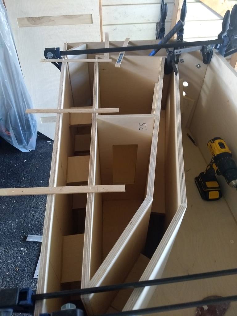

Almost getting there.
Just need the mouth stiffening and last side plate, Hope that will be less work then last time :)

A question because I'm not sure if I'm seeing things right but in the last image, the panel marked P5, does it have a rectangular hole in it?

88h88 wrote: Mon Sep 09, 2019 9:22 am A question because I'm not sure if I'm seeing things right but in the last image, the panel marked P5, does it have a rectangular hole in it?
Probably has two rectangular holes in it. That's used with drivers other than the Lab12....or any driver with FS above 35hz. I can't tell what driver that is, but it doesn't look like a Lab 12.

It has a hole, the driver is a eighteensound nlw9300 http://www.eighteensound.com/en/product ... /12NLW9300
So rather light compared to a lab 12

Bruce Weldy wrote: Mon Sep 09, 2019 9:35 am Probably has two rectangular holes in it. That's used with drivers other than the Lab12....or any driver with FS above 35hz. I can't tell what driver that is, but it doesn't look like a Lab 12.
Gotcha, I've never put anything other than a Lab12 in a sub so I wasn't aware of any differences in the plans!

88h88 wrote: Mon Sep 09, 2019 12:26 pm
I saw that hole in the pic too.....after you posted, I went and looked at the plans. Not sure why people want to use the Lab when the 3012LF is so much lighter and the same price....and the output is essentially the same. Just like to get in some extra weightlifting? :mrgreen:
