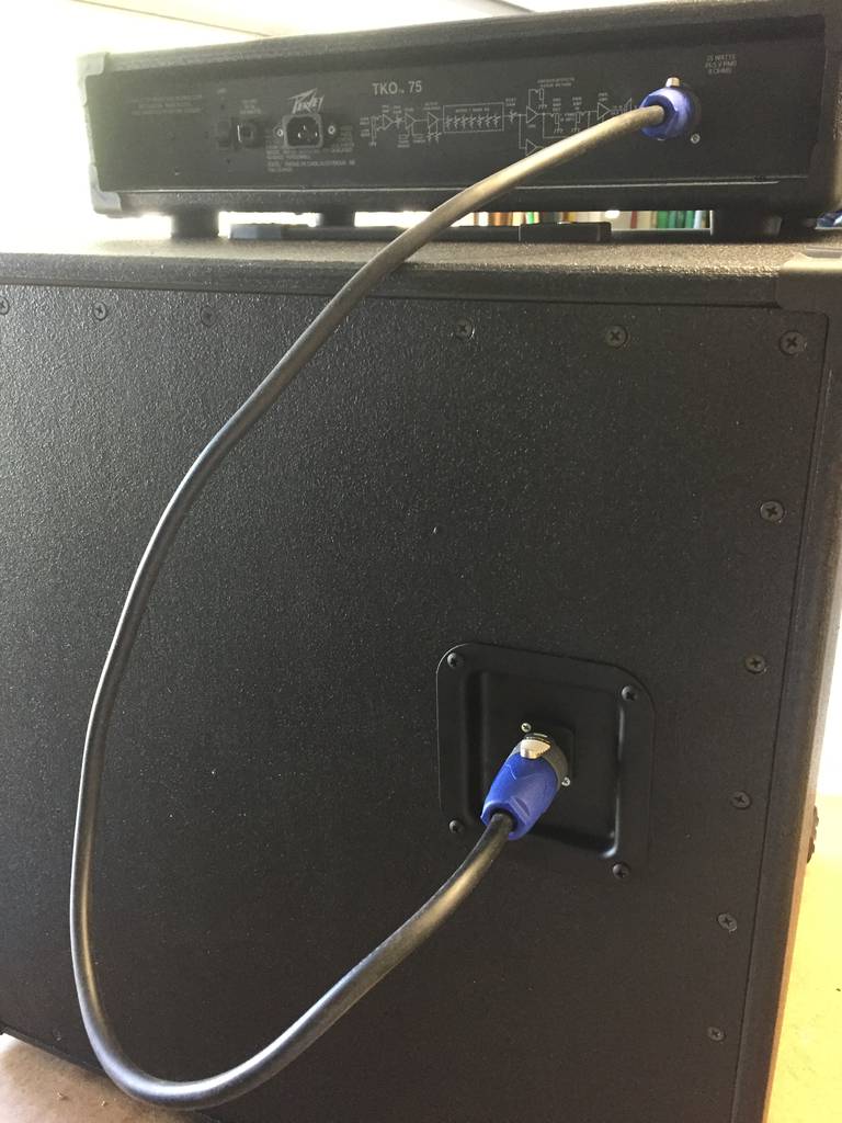

Got the foam installed....a old mattress topper and a spray can of adhesive.....
Once that was done, I put together the amp and added the feet and corners..
Put in the speaker and put on the back cover in order to find the center point for the handle. The plans were right on - it lined up right on the baffle. Took the back off and the speaker back out to install the handle.
One thing that's always been a PITA on my past cabs was trying to attach the crossover to the cab....trying to use a short enough screw to not punch through the cab....This time I added two little 1/2" blocks to use for securing the crossover. So easy.....don't know why I didn't do this before - now there's plenty of room for a decent screw. (insert pun here)....
