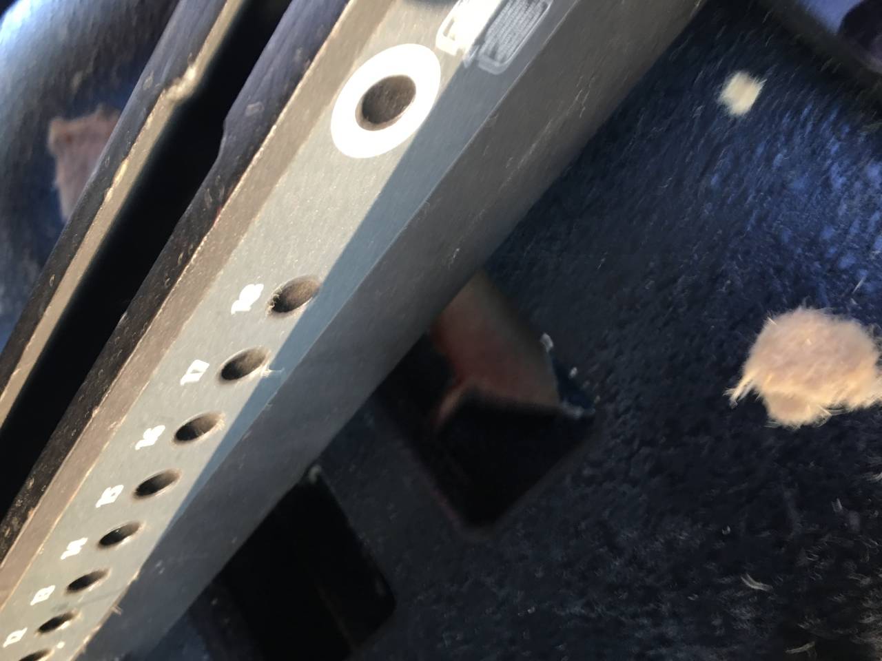

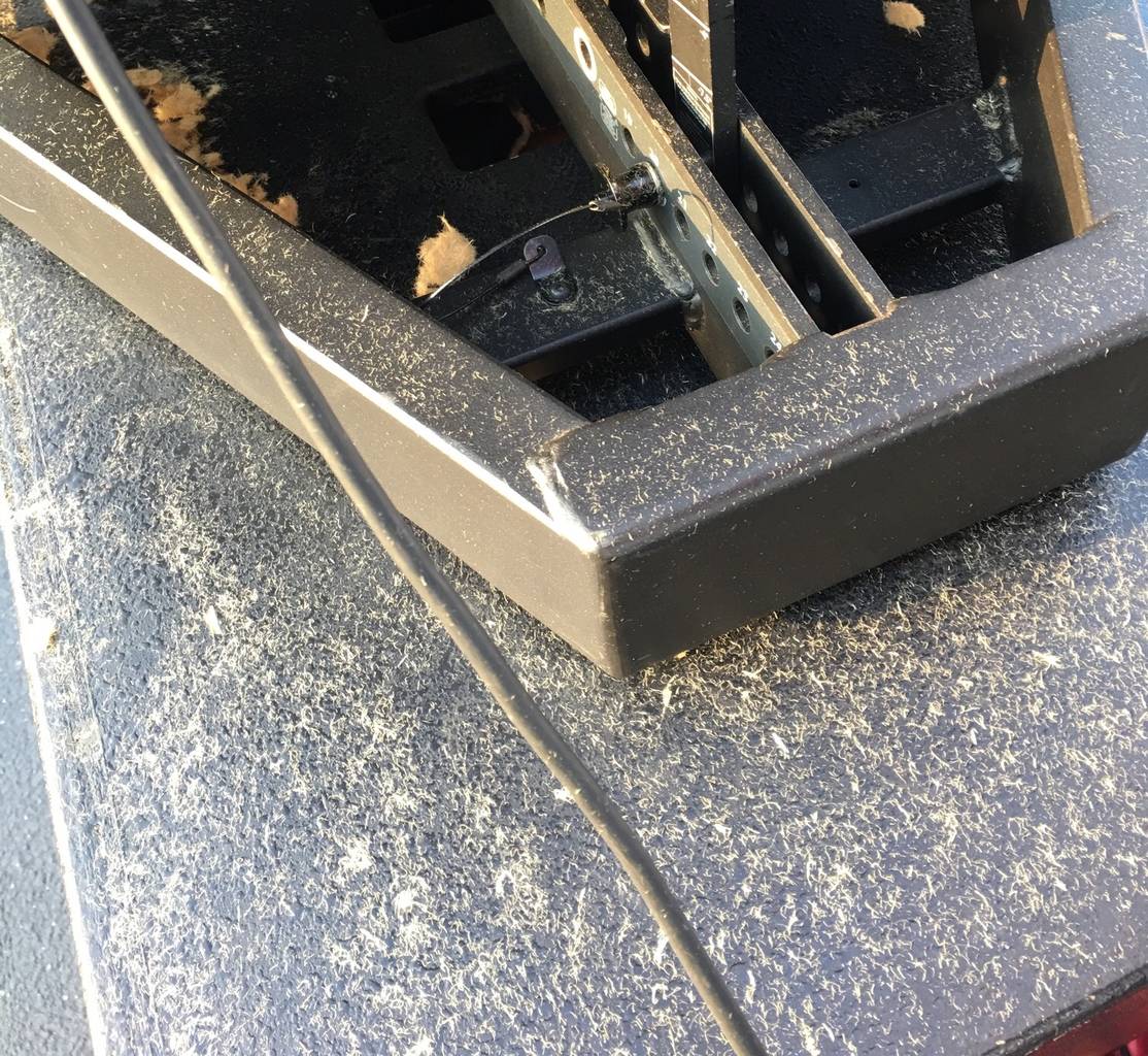

Uptown Funk is why. If it ever gets wet (as these did) and Uptown funk is played, you get sawdust.
These are Baltic birch cabs coated with duratex. Except for the handle cups apparently. I’ll have to have a word with the guy that built them. Notice the way it shredded. The Duratex had to be holding it together for some time.
