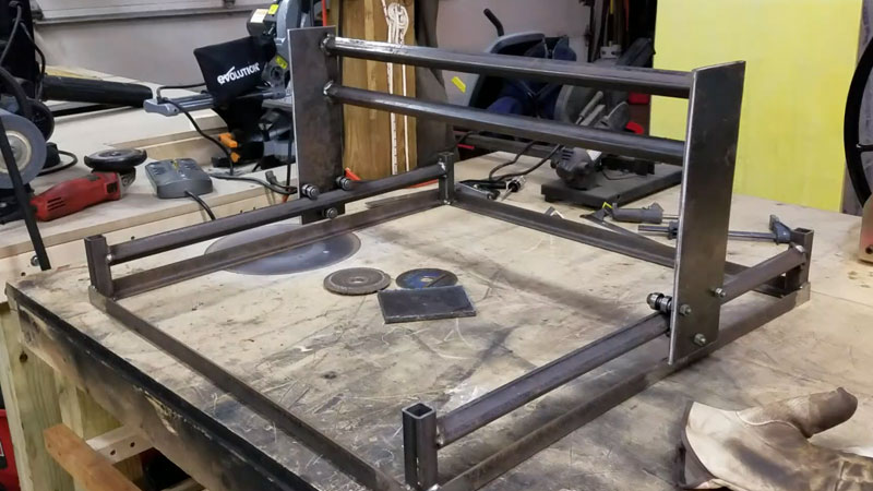

Ah well, that's not gonna stop me. I'm the guy with the hammer remember?! So.. after drafting up a few more masterpieces on some rather used looking napkins, I broke out my grinder and got busy. That million dollars isn't going to create itself ya know. And off I went.
Unfortunately for you, I didn't take any pictures of that phase. By the time I remembered that cameras existed, I already had the base and Y carriage completed:

That's a heapin' helpin' of cold-rolled steel ain't it?
Here's the nuts and bolts of that (see what I done there?).
I simply cut four pieces of L channel at the same length and welded those suckers together in a rather symetrical patter, what with several right angles and similar side lengths, what the heck is that called again. Oh yea, a SQUARE. I then added four 1"x1/8" square tubing (there's that word again) to each corner, not just because they are cute as hell, it's because I have a plan for them <wrings hands> Mwhaaa, haa haaaaaa.
The uprights are 3/8" plate steel and that's all I have to say about them.
The rest of the 1" tubing you see, has been rotated 90 degrees from plumb and in case you can't see too good, that's where the slide bearings are gonna slide! (Please tell me you see them on the Y axis carriage)

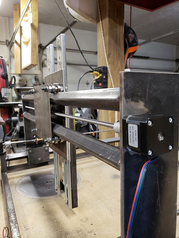

Just for yucks, and obvious foreshadowing, I even had the drawer slides for the Z carriage propped up on her!
Here's a hind-view. Just for your viewing pleasure. (psst, don't tell the missus!)
BTW, pay no attention to those apprentice welds. I've since replaced my old knock-off flux core jealopy with GAS! Either way, how does the old saying go? Oh right- "A grinder and paint make me the welder I ain't"
Well now the only thing to do is put some running gear on this beauty right? And that I did.
First, I just knew this thing would have to run on motors, and those motors would have to use something to move that steel, so I immediately thought, what about some screw thingys? (<--Caution; engineers mind at work) I got on the horn and called Wil E right away, since he is my source for everything, and wouldn't you know it, I ended up with about four ACME rods. Oh, that Wil E.
These aren't your average threaded rods, they are smooth as butter and well, faster than butter as well, not that I would know how fast butter is. (I'm just gonna stop right there.)

So, where was I? ... Oh yea, so soon after I affixed all of the ACME rods to their respective carriages, along with the motor mounts, anti-backlash nuts and the above pitured pillow blocks (See, I TOLD you I had a use for those cutesy 1" tube stubs!) I then got some electramatronicals!
Yup, three more NEMA 17 motors, Arduino board with CNC shield, limit switches, 4 DRV8825 stepper motor drivers and power supply! (Ahhh, I love summer Christmases) That got me to a-wirin' right away and homemade router hole be damned, I was a-gonna see this thing move soon!

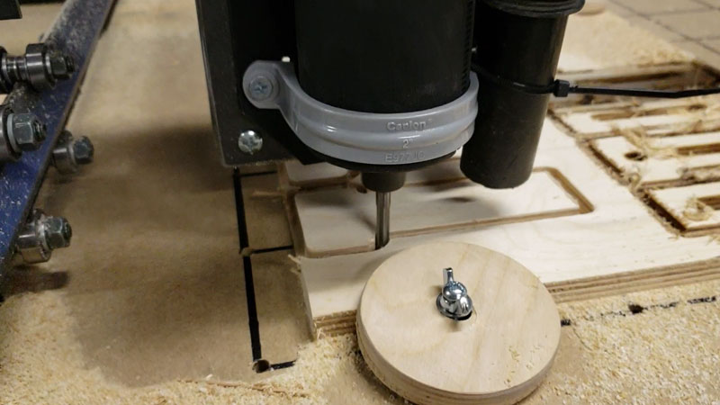

Seriously though, as cool as that would be, it's not a bullet hole at all. It's actually where my bit tried to go after the engraving was 'finished". I have no idea what demon from hell injected itself into that rendering, but I can tell you it was mad enough to throw smoke out of that hole ('till I shut the machine off that is.)
Now I know you are all on pins and needles at this point to find out what I did next. Well, like I said above, I decided to put her to test building a tool that would make her even better. Do you see the round biscuits in a couple of pics ago that are holding down a work piece? Well, ironically, those are fall downs from several cornhole and speaker builds I've done. Problem is, they are better as fall downs then they are as clamps (whoodathunkit?) So to flex my chops, I decided to upgrade them puppies and here's what happened:
SUCCESS!!
Look how jelly the biscuits are now! hahahaha.

Alrighty, finally, a successful run.
Now, on to the reason this thread even made it to what many would consider a rather unconventional place for it- one of the primary used I had in mind for it! If you figured it out- YOU WON!*
Yes, that's right, one of the main reasons I built this was to get freaky making those items that we all either dread or suck at. Want proof? Ok, it's all explained in the brochure. And by brochure I mean my short, hackneyed video clip hee hee:
That was a lot of fun, let me tell ya. Took just about 27 min to create each, a time I can surely cut down with some tool speed adjustments. I really wanted to keep my straight 2-flute sharp (that's what he said) I also didn't want to burn the pieces. Still, 27 min is probably less than it takes most to cobble one out with hand routers and jigsaws. I can't complain.
