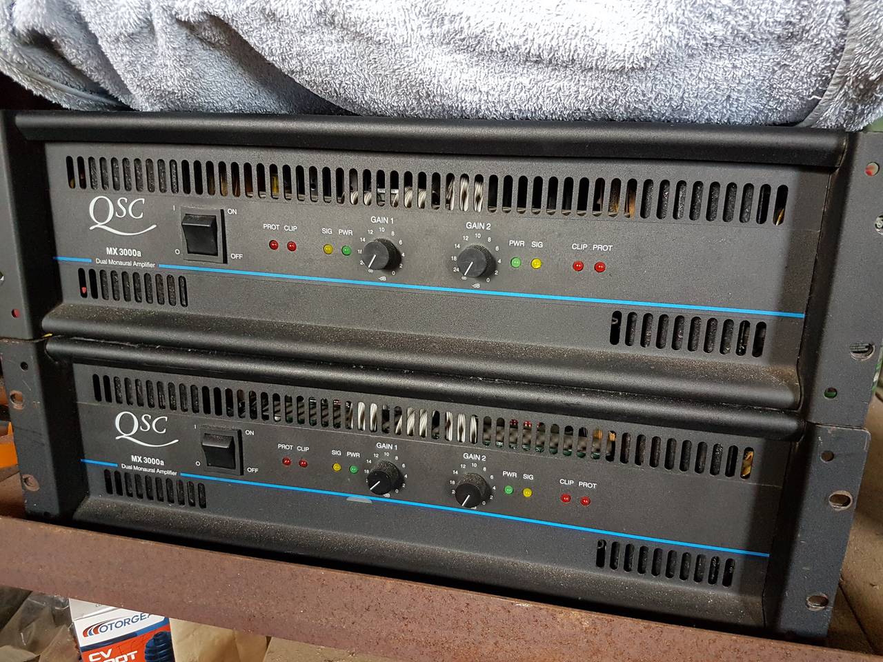

Buying the amps.. no problem, but pricing up to make the power sources has made it not worth effort going that way for these cabs. I've found two QSC 3000s for $220ea, came from a permanent install, plenty of grunt, and I forgot how nice it was to have an actual EQ you touch with your fingers!, guess I'll be saving digital three way happiness for HT.

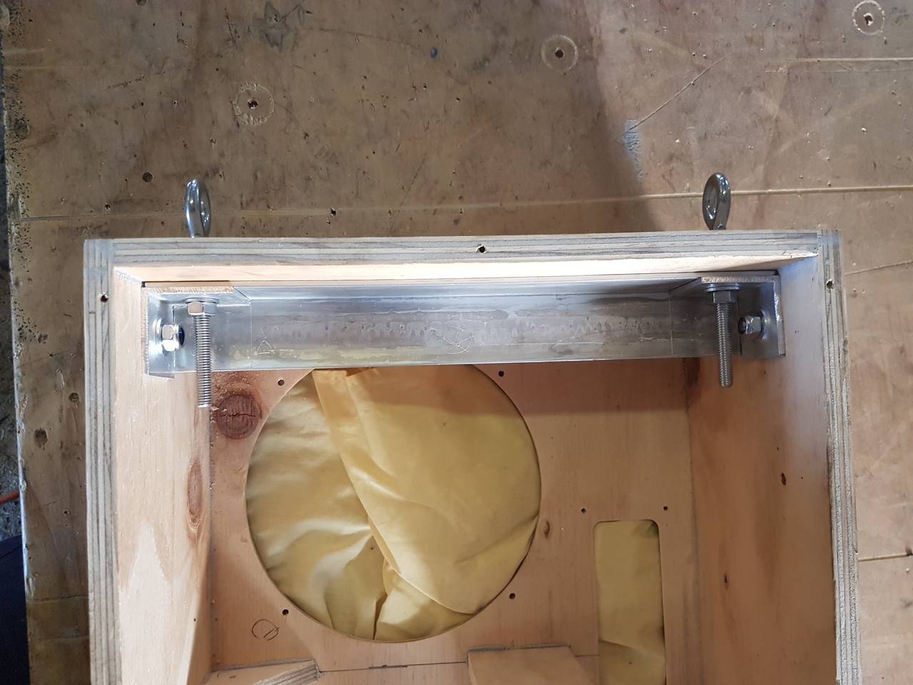

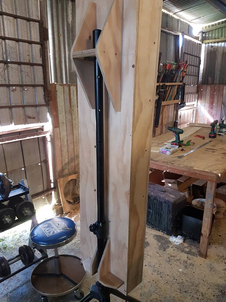

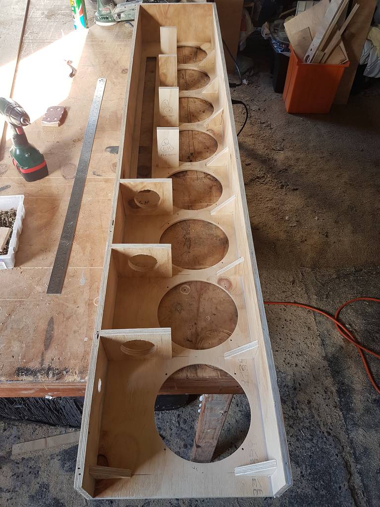

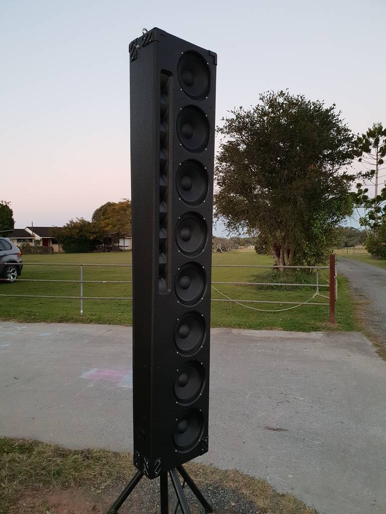

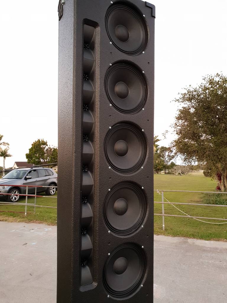

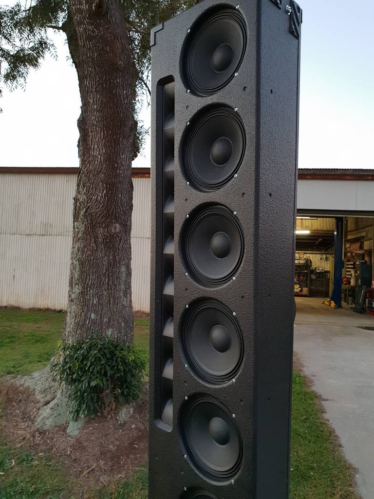

After mocking up the cab, I found them super heavy, and with the pole mount centered it doesn't want to sit happily on the stand. So I found moving the pole mount to 10mm to the inside of the woofer centreline, the cab is resting nicely.
I'd use 3/4 ply for the baffle next time as the 1/2 felt a bit flimsy, so beefed up the bracing and pole mount.

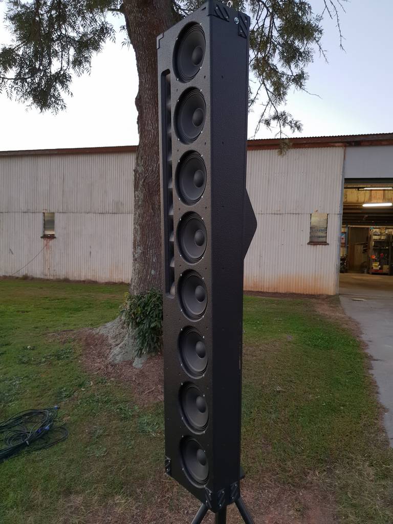

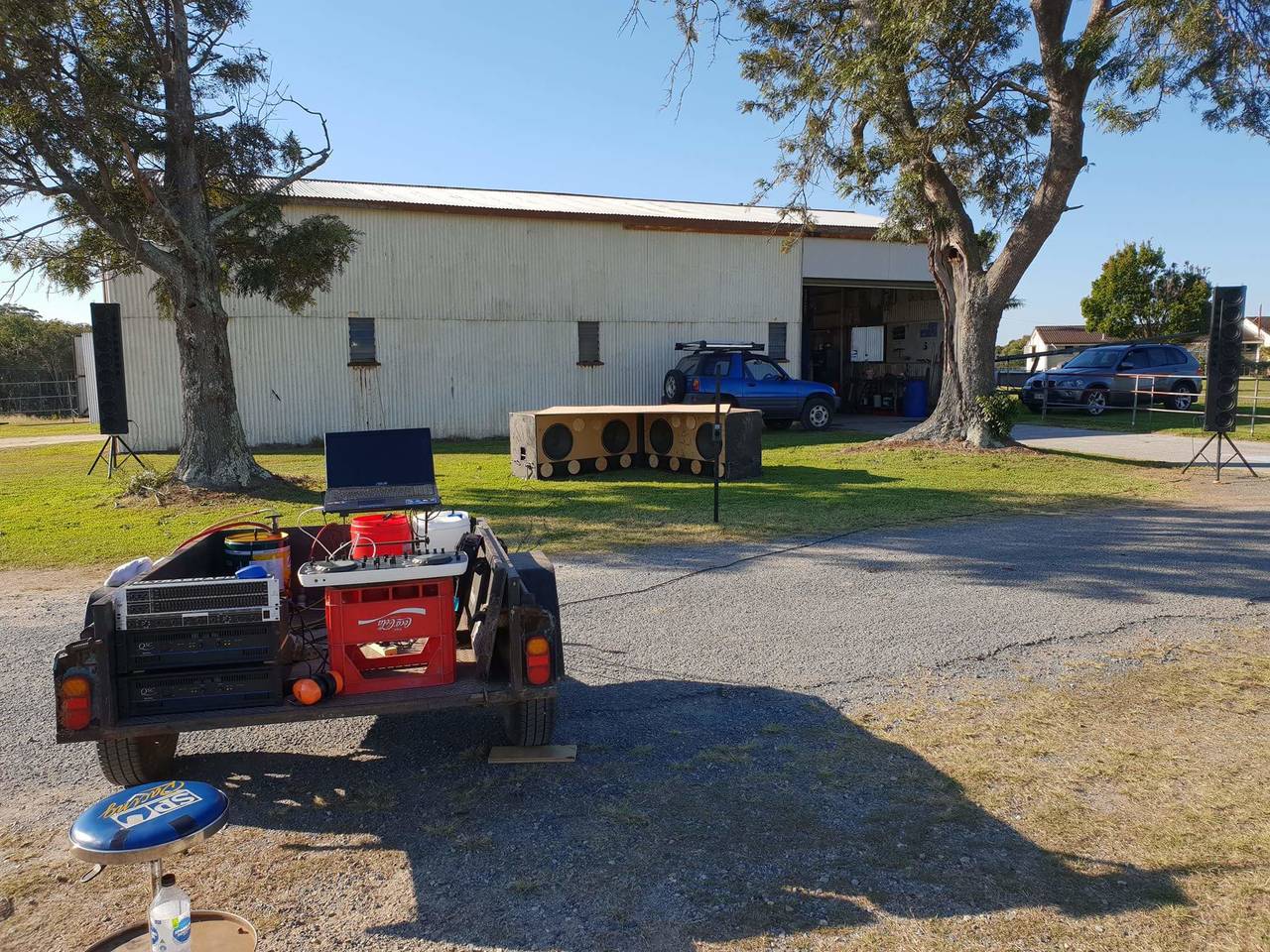

Finally had time to set these up outside and give them some juice for the afternoon, with a pair of dual 18 cabs which just kept up. The sound is Amazing, even 100m away down the paddock, the sound was full, smooth and tasty!

Thank you all for the kind words! The weight came to 46kg each, doesn't really sound heavy, but maybe they're just awkward for me to move around and fit on the stand.
I'll be flying these in my shed for music (and for storage), and to see if I can get away without subs for the everyday tunes. Hoping the brackets are strong enough, what do you reckon?
I didn't fill the countersunk brace screw heads to see what it looked like under paint, and with a large surface area, one scratch instantly draws your eye. I'll see how that theory stands up over time as they wear.
I Had to cut 4-5kHz 12dB to sound nice to me, is that just the 8" drivers?
