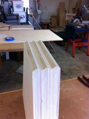

The important thing is that it has equal plies. You don't want thicker interior plies with a thin veneer on the outside.
It should look like this...I know it looks weird, but that's several pieces next to each other....you can see the equal plies.

Yeah, I read about delamination issues with the veneered plywoods!Bruce Weldy wrote: ↑Fri Apr 20, 2018 8:21 am The important thing is that it has equal plies. You don't want thicker interior plies with a thin veneer on the outside.
