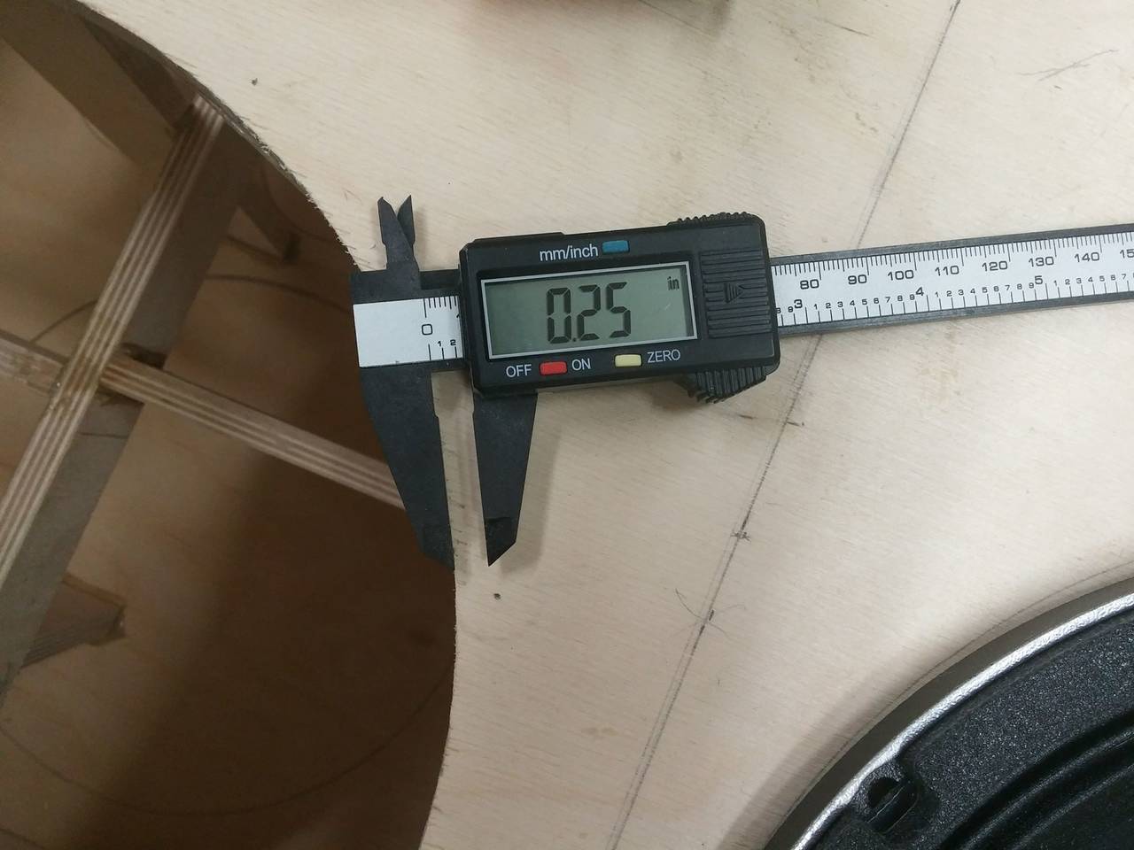

#115 Post by Electric Wisdom »
Some pictures, the dot is the center for the screw, and both lines are what i can have of free space when i move the woofer around in the hole.
There's a shy 0.25" between the screw placement and the hole edge i cutted. :S :cussing:
Posts: 8615
#116 Post by Bruce Weldy »
Electric Wisdom wrote: Sat Mar 31, 2018 4:35 pm apparently i cutted the hole at 11 1/8" wide :(
That's only 1/16 bigger in diameter than it should be....meaning only a 1/32 at any point.....that's not a problem at all.
