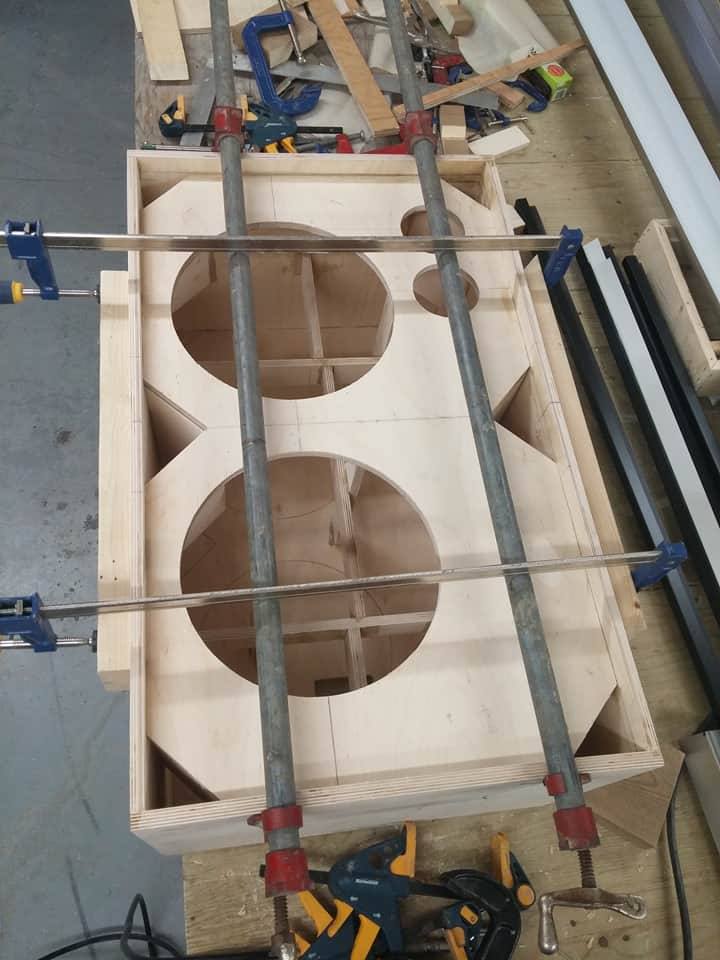

Yeah lesson learned, i knew i had to do it first but then i forgot and he said that so hahahh but today i glued the baffle and it looks perfect, with precise and lost time measurements done lol Yeah i looked inside with my smartphone video recording, everything sits properly but i had to be very very meticulous

Little wood pieces glued
