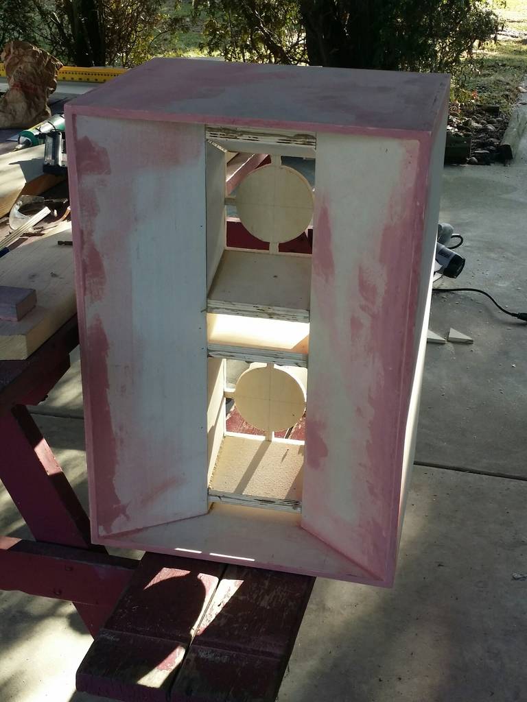

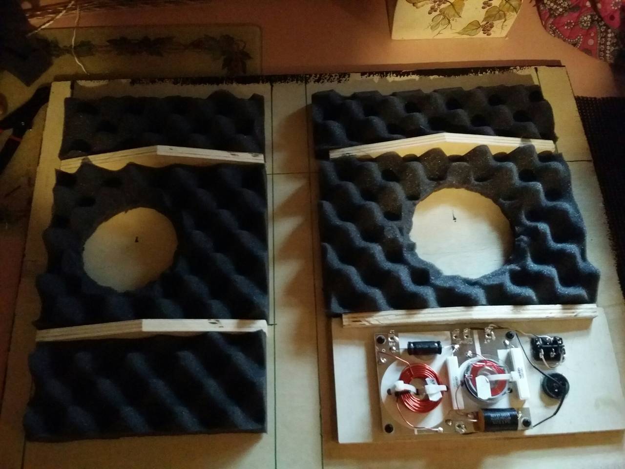

Finally got the chance to post some of the build progress pics.
