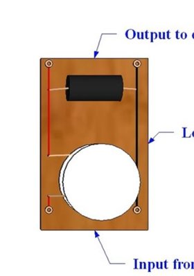

#3 Post by Electric Wisdom »
So... first thing i'm not sure... what is this circle hole from the simplex 12 build document?
It's the paid plans... i posted a small picture, don't want to post this stuff as free as little as possible, let me know if it's not accepted here.

#5 Post by Grant Bunter »
Electric Wisdom wrote: Fri Mar 02, 2018 6:36 pm So... first thing i'm not sure... what is this circle hole from the simplex 12 build document?
It's an inductor

Grant Bunter wrote: Fri Mar 02, 2018 8:18 pm
It's an inductor
Ohhh thanks :) haha

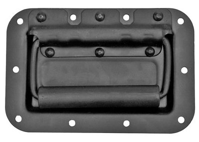

i cant buy easily and quick the same handles as the plans, they seem smaller than all i can get, can i use theses instead?
The ones i see at stores in canada are bigger and i fear they will cause problem because of the thigh space with the inside braces.

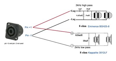

#12 Post by Electric Wisdom »
So i made this, just wondering if any one can confirm it's good? Please please? haha
If i check the 3d plan they are in parallel, both woofers in parallel, in parallel with the tweeters that are also in parallel, that makes a 8ohm cab ? 8+8 ohm in parallel is 4ohm but i'm not sure how it works with the crossover and the 2 speakon connectors also in parallel
I would think woofers would be in series to get 16 ohm, tweeters too at 16 ohm in series, then tweeters with woofers in parallel to end up at 8ohm?
Posts: 7652
#13 Post by Tom Smit »
Not quite. Since you are planning to parallel wire the drivers, you need to count them as 4 ohm....each set will be 4 ohm.

#14 Post by Electric Wisdom »
Tom Smit wrote: Fri Mar 02, 2018 10:46 pm Not quite. Since you are planning to parallel wire the drivers, you need to count them as 4 ohm....each set will be 4 ohm.
Ok thanks so that picture i posted is a wiring for 2ohm cabinet right? This is whats by default planned for the 212 simplexx?

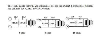

#15 Post by Electric Wisdom »
What represent exactly the 4,8,16 ohm title under each tweeter crossovers?
I have to choose the middle one for the tweeter and woofer that i use (which are 8ohm each) ? or does it refer to the cabinet total impedence with the used wiring setup?
Or... since i will wire the 2 tweeters in parallel that makes 4 ohm so i must use the left diagram for the crossover for the tweeters? then same concept for the woofers?
