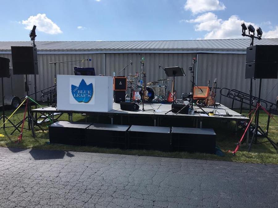

Here are a couple of photos from an event we did yesterday. My friend's band played during dinner and during the intermission of a private corporate airshow. We knew that the crowd would be large but I think it was a bit bigger than anyone expected. We used my four T39s and four OT12s plus the bands QSC K12s for side fill and another pair about 250 feet away where the dinning tents were located. There was really only room to lay the subs across the front of the stage but that worked fine. If anything we really needed more mains. Four more OT12 would not have been too much. The sound was good from the stage to about the halfway point in the crowd. After that is dropped off pretty fast which was okay since most people were there for the airshow but could move up if they wanted to hear the band.

Bill, would there have been any low end benefit to standing them all up, side by side, facing the crowd? Maybe less low end cancellation? (It would have obscured the band's knees and shins, no big deal.)

No cancellation as long as they are within a quarter-wavelength......if I remember what Bill said a long time ago.
I've laid mine down like that with no problem.

Is that measured center-to-center or edge-to-edge?
I'd assume edge to edge, as a quarter wavelength at 120Hz is about 28 inches... and some BFM horns are wider than that.

Edge to edge.
And a cancellation at 120hz is usually a good thing! :mrgreen:

From the sub placement guide: "The basic rule is to have them either less than a quarter-wavelength apart or more than two wavelengths apart for their pass band, which for 40 to 100 Hz means less than 2.8 feet or more than 56 feet."
I did have a v-plate in the trailer and consider stacking and plating for a few more dB. But laying them out across the font was definitely the most workable arrangement. It's not obvious in those pictures, but there had been nearly 3" of rain a few hours before we arrived. The grass was full of standing water. The driest area was the front of stage and still we had to put the subs on tarps to keep them dry. Also there are pieces of plywood under the rear speaker stand legs to prevent them from sinking into the ground.
