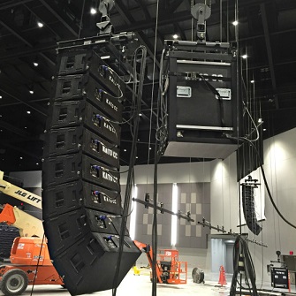

I would have to see the design details to comment. However, the path of the DR280 is 3 feet.
* RCF and (if I remember right) JBL make horn loaded compact line arrays. Probably several other makers also.
Here's one of RCF's the HL-2290. This is just one example, not saying this is the best example available.
Also HL-2260 (60 degree horizontal) and HL-2240 (40 degree horizontal) are variations.
http://www.rcf.it/installed-sound-systems/h-series
User manual with cabinet diagrams and plenty of cabinet flying hardware details:
http://www.rcf.it/c/document_library/ge ... pId=216492
These HL-2290 are obviously 2x the weight, and at $4500 each plus $1375 for the top Fly Bar, 15-20x more expensive than the DIY BF J array Otop12.
* A pic of the L'acoustics Kiva II line array - see how small they are.
http://www.prosoundweb.com/channels/liv ... velopment/
It'd be nice to have a fully horn loaded line compact array element design with provisions for an inexpensive pro quality class D plate amp, for the DIY sound system engineers.
amp edit-2.jpg (62.44 KiB) Viewed 19928 times

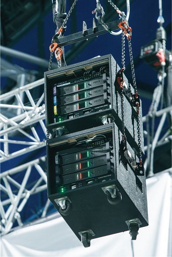

* Flying amp racks is super risky, expensive for the added insurance and mechanical engineers and rigging gear and certified riggers, and just insane, in my humble opinion, when you can simply add a pro class D plate amp weighing about 5 pounds into each cab and incur no additional risk or secondary expense, beyond the plate amp itself, which can and should be had for relatively cheap.

If flying the rig? I'd never run powered stuff unless I had instant access to a scissor lift or had the speakers on motors so that I could lower them (either would be impossible in the middle of a show). Flying amp racks is only done when the event requires a clean floor. I'll keep the amps where I can get my hands on them. Not a concern to me as I'm not gonna fly anything anytime soon. I'm done with big events.
