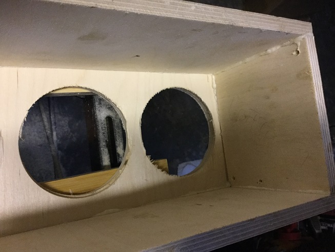

Got quite a bit done over the weekend, and completely changed my original plans. After studying the David plans a bit more I realised some of the recommended speaker specs were the same as the Tuba 18 and SLA mid drivers. So I decided to buy more drivers and use the ones I currently have as an experiment. The benefit of this means I can knock together some practice cabs and not have to worry too much about them looking nice.
So the plan currently is:
2 x 6 driver SLAs using the McGees I already have (these will live in the garage), 2 x 4 driver SLAs, 1 curved SLA using DYNAVOX DY103-9A and this tweeter http://www.pollin.de/shop/dt/MDI3OTUzOT ... ttro_.html, 2-3 surrounds using the McGees.
1 x Tuba 18 using the Dayton Audio DCS205-4
2 x Davids using the Dayton Audio DCS205-4, DYNAVOX DY103-9A and SoundLab 1" Dome Tweeter
I anticipate this taking approximately forever.
In the mean time, some pics of progress so far.

Here's where I'm up to with the 6 driver SLAs; building one at a time.
Looks pretty rough, my saw isn't cutting very cleanly so I'm going to get some thinner blades for the next one. Also, some of the angles etc are a bit off and I'm hoping some heavy sanding will correct this. My first experience of PL type glue was an interesting one, it started to bond much quicker than I was expecting so the final fit was a bit of a rush. I used screws as fasteners and think I'll try using clamps and some proper jigs for the next one and trim the parts to fit a bit better prior to glueing. I only installed the drivers so I could test it out and temporarily wired this up to the stereo last night with a false back and it already sounds amazing to my ears. I'm going to remove the drivers for finishing and then reinstall them with gaskets etc in a straight line.
Hopefully I'll get this finished and the second 6 driver SLA built next weekend as I'm away with work this week.
