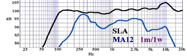

I was wandering around in cyber space last night and found an SPL chart of the speaker in my current guitar amp
and here is the SLA Pro's chart

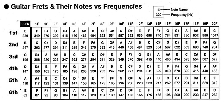

Given low E is at 82Hz (as shown here)
I think I'll be very happy with the 6 inch SLAs
Maybe the only issue will be if I use the synth to play a Bass line. time will tell...

Neil,
Mate, do you sing as well?
If yes, the almost flat response of the SLA's is a great way to start at each venue for room tuning.
A bit of judicious tweaking of the channel strip EQ on your 802 would get you pretty close to the texas heat chart as well if you like that sound.
If you go sans subs, then the SLA's will probably give you no fundamental, but some of the first harmonic, and certainly the second harmonic.
That is no worse than some cheap bass cabs can do lol...

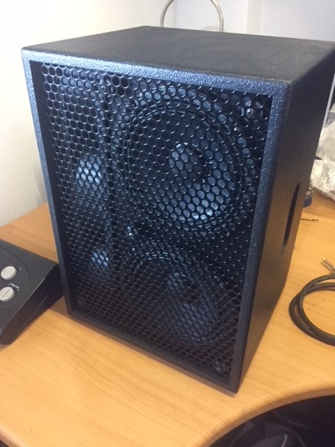

Thought I'd give a quick update of where I ended up. Mainly cos I had a heap of fun getting here :-)
I built 2 SLA Mini's and went a gigin'

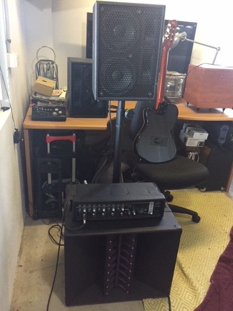

But they are not low enough for the sounds I was after. Cut a long story short - after lots of trial combinations, I simply shoved one SLA mini on top of one Jack 12 and wholla!!
I went with the Behringer. It's fine, fairly light and loud enough. Sure the Yamaha would be better but it does me.
So now I size my rig according to the room and how many people and my mood.
  • 2 SLA Mini's,
  • 1 SLA Mini on 1 Jack 12
  • 2 SLA Minis (stacked) on 1 Jack 12
  • 2 * (1 Sla Mini on 1 Jack 12)
Thanks for everyone's help and comments and as always - thanks to Bill and his designs.

If you had the right tool for the job of handling lows, a Tuba or Titan, the results would be much better.
NeilD321
Posts: 112
Location: Kiama, Australia
Re: Solo Gig Rig - Advice
#30 Post by NeilD321 »
Agree 100% - I have a Tuba 18 on my home theatre upstairs so tried it out. It is better. But it's also heavier and I already bought the amp. Oh well. Still sounds great. Thanks Bill.
