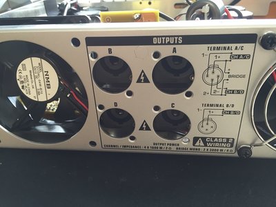

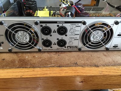

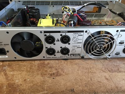

This actually was pretty easy. The fans are designed to be installed either direction. Popped it open by taking off the top and taking out the four screws that are on the outside of the fan grills.
The one of the right went pretty easy, but the one on left was harder. The wires for both fans run underneath the board with the speakon jack. Then they hit all the wires with hot melt. There wasn't any slack for the one on the left......so, I had to take out the screws that held that board and move it up some. I was able to go through the bottom holes and pry the hot melt loose. That gave me just enough slack to get the left one out and turn it around.....
Put it all back together and it's blowing the right way now.

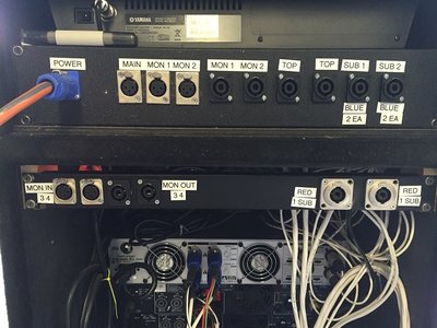

Kinda' cheesy looking with the round front and psychedelic knob lights......but, it all works and my back will be happier.....
