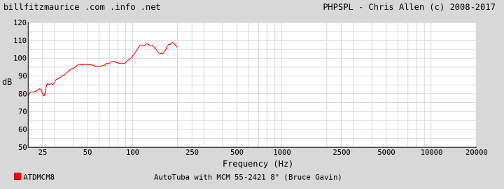

MA043HA wrote:lowpassing it about 120Hz 12db/octave .... to the point where the bass gets localized in the rear of the car...The slope isn't adjustable but could be if I started using the HU to set xover which it is not doing at all now.
That x-over point seems too high. If you look at the autotuba graph, it gets really efficient from ~90hz and up. That would be the source of your localisation. If you could increase the slope to 24db/octave it would help you out as well as lowering the subwoofer crossover point to around 70hz or so. You can leave your high pass crossover where it is. There won't be any "hole" by leaving a gap in the crossover range as x-overs are a slope and not a cliff, there will still be plenty of 70-120hz bass coming through.
