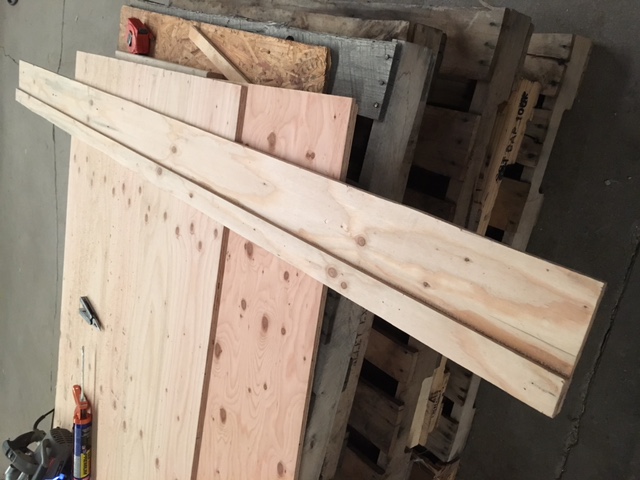

Re: New member/first BFhorn/Tuba45
guide rail check, i have been using guide rails for years now always just clamped a straight edge to the work piece, it took a long time to properly align up the rail for a perfect cut, this way makes it so quick and easy. I have never used PL before, i have always used liquid nail or industrial wood glue, so far i like the way the PL seems to be working out, i made sure to pick up a large-ish supply of shop towels to protect my self.
Use these.....ACUA wrote: i made sure to pick up a large-ish supply of shop towels to protect my self.
http://www.harborfreight.com/5-mil-nitr ... 68497.html
You'll learn how much PL to put down with minimal squeeze out and less mess as you go.
