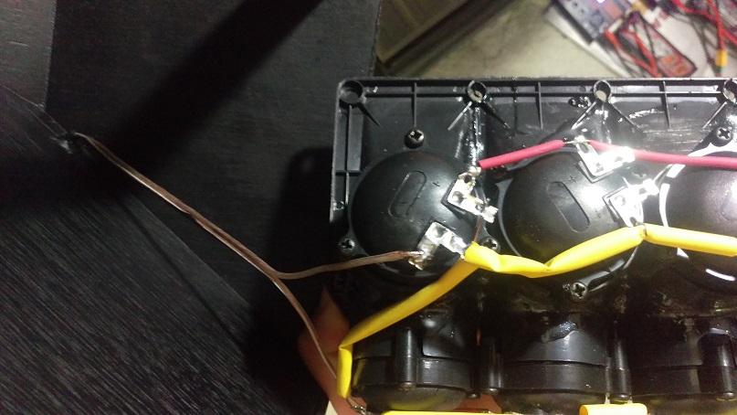

Hey Dan, if it's not too hard pull one and take a pic of the backside and send it to me. I haven't made a mistake on arrays in years, but that does not mean it could not happen. Also show where you connected + and - to the array. It's easy to get them backwards. You can either post it here or send it to me directly. webmaster@speakerhardware.com

Leland, photos as requested. The first 2 are a zoomed out and zoomed in shot of what I've connected to the +ve on the crossover, and the 2nd 2 are of the -ve side.

Chris_Allen wrote:I took an old array out of a Jack 110 and put it in something else and it sounded like it was knackered. Turned out I had attached the initial + and - to the wrong end.
I'm hoping that's what I've done Chris, although the arrays in their current wiring sound far from knackered; they sound amazing! Super clean, crisp and crazy loud while retaining that clarity.
