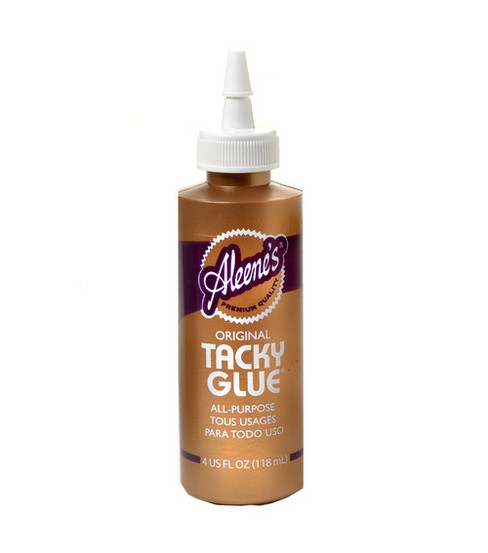

I created a thread to see how bad I screwed up (down actually) and get some fix suggestions. http://billfitzmaurice.info/forum/viewt ... =7&t=23180 One of the suggestions was for Aleene's Tacky Glue, and we happened to have some around the houe. I used that and it has worked great. Unnoticeable.

Guitbusy wrote:I created a thread to see how bad I screwed up (down actually) and get some fix suggestions. http://billfitzmaurice.info/forum/viewt ... =7&t=23180 One of the suggestions was for Aleene's Tacky Glue, and we happened to have some around the houe. I used that and it has worked great. Unnoticeable.
+1. Superglue doesn't stay flexible.
