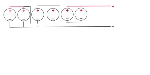

is this correct to get 6 ohm using 4 ohm driver? (wiring)

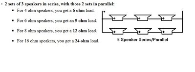

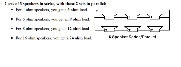

Also I found this diagram on the web which I think is the same thing. (wiring 2)

johns811 wrote:is this correct to get 6 ohm using 4 ohm driver? (wiring)

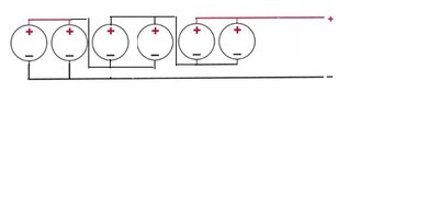

Ugh...I was wrong

The second one is from a set of Bill's plans I think you will find.NukePooch wrote:The first one is correct. Two banks of three drivers per bank.johns811 wrote:is this correct to get 6 ohm using 4 ohm driver? (wiring)
The second picture is incorrect, three banks of two drivers per bank. This will likely let the smoke out of your amp. (or it will just shut down)
And it doesn't matter, either way is correct.
In example 1
3 x 4 ohms in series is twelve and 2 banks of those in parallel = 6 ohms
In example 2:
2 x 4 ohms in parallel is 2 ohms, add 2 ohms for the next pair, and again add 2 ohms for the third pair because you connected the three pairs with serial wiring, and you get 6 ohms...

It looks the same to me, just drawn a different way. Thanks for the feedback.NukePooch wrote:The first one is correct. Two banks of three drivers per bank.johns811 wrote:is this correct to get 6 ohm using 4 ohm driver? (wiring)

Thank you, yes the 2nd drawing in the style Bill uses, I can understand it better for some reason.Grant Bunter wrote:The second one is from a set of Bill's plans I think you will find.NukePooch wrote:The first one is correct. Two banks of three drivers per bank.johns811 wrote:is this correct to get 6 ohm using 4 ohm driver? (wiring)
In example 1
In example 2:

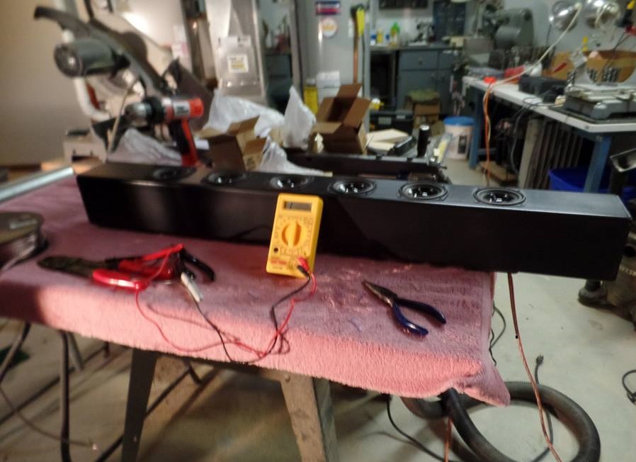

I think I got the wiring correct, the volt meter said 6.5 ohms. They sound really good, should meet my needs for a small speaker that is light and easy to haul around. Total cost was about $100.

Measuring resistance across the drivers does not equal the impedance of the drivers. 2 different specs that behave and affect the cab differently.
In your picture, it appears that your drivers are spaced quite a bit apart, nearly a driver's width. This is going to cause a lot of comb-filtering. If you are happy, so be it.
Re: Series/parallel wiring question.
Not sure how I ended up spacing them that far apart. The cabs cost $8 each and this was sort of an experiment. What is the effect of comb filtering?

I don't think it will be all that bad since it's vertical and not horizontal.johns811 wrote:Not sure how I ended up spacing them that far apart. The cabs cost $8 each and this was sort of an experiment. What is the effect of comb filtering?

You'll never hear it once you're about two feet from the speaker. PA line arrays have that much space between cabs easily.DJPhatman wrote:Measuring resistance across the drivers does not equal the impedance of the drivers. 2 different specs that behave and affect the cab differently.
